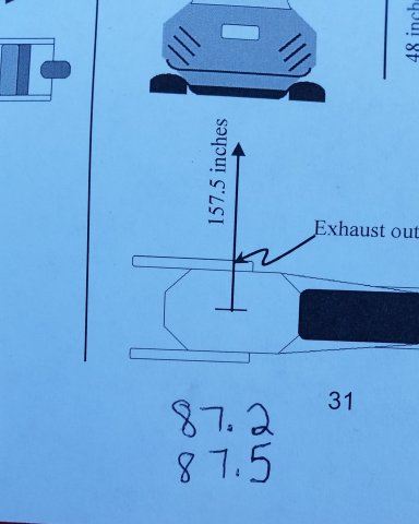

Here are the specs on how the DNR does their sound decibel test. I have other pics, but can't get them to upload because they are over the limit. But, here it goes....
They take their meter, attach a calibration device to the end which reads 114.2 and then they calibrate the meter. This was repeated twice to make sure the information was accurate. The 2 readings were 87.2 and 87.5 which averages out to 87.35 and is legal. I know boostednytro has a couple videos and maybe some pictures he will upload.....
