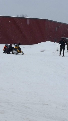

11/7/16 DNR Agent came out to my house to do decibel readings on the Evolution Powersports Magnum muffler.
Here are the measurements of how the sled gets tested. Wisconsin rules say the distance measurement is 13.1 feet from the center of the sled, same side as the exhaust side and the meter has to be 48 inches from the ground. The sled must be warmed up and held at 2,500 rpm's and must be under 88 decibels.....per their paperwork. The Agent also took my paperwork about the 4 stroke engagement to be totally sure everything was on the up and up.
The bad thing is the meter was giving the agent problems. Installed new batteries and still wouldn't work correctly so now Friday the agent will be back and perform the test once again.
Checked my phone decibel meter app to the calibration device and it was very close....but is not calibrated so a final reading will be with their meter when it's working correctly. But this showed me that the app is very close. With that said....the EVO Magnum muffler passes my sound meter test 5 decibels under the limit.
Pictured along with the Agent is another TY member who came to watch the process.

Awesome stuff thanks for the info on testing in WI. Thinking that can will pass easy..
They usually give a TINY bit of slack on them depending on the Warden.
Michigan does give some leeway for sure. At least from what I read and hear from others..
Kinda depends what your getting stopped for also(if you blow a stop sign or speed and or drive out of control)(AKA hot dogging it) - you better be UNDER for sure.

I thought Michigan was going to give some leeway to a friend of ours during I-500 weekend....but no, he ended up with a $250 fine I believe it was.
