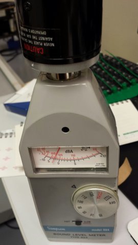

Can you get your hands on a true decibel meter? I wouldn't trust a smart phone app to be very accurate.

Mighty, I have a decibel meter (calibrated) at work right now that I use for machines. I tested this against my smart phone app and was pretty close....but as mentioned, I want the final word from the Wi DNR Agent.

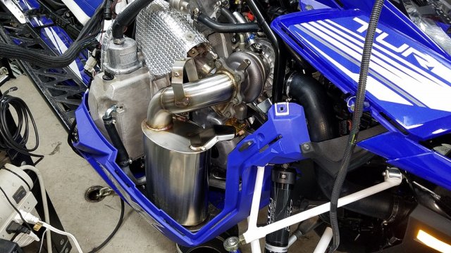

Looks sneaky enough behind the factory heat shield that it just might fly in Ontario. Will this be the quiestest muffler that evo will offer?

Copied this from EVO's post where they are testing and dynoing the Sidewinder. Stopped by Jim last weekend and saw his Magnum Muffler for the Sidewinder. Told me to take the Magnum and do some decibel testing to see if the Magnum Muffler creates HPR and is still trail friendly....The answer is YES!!!! Great job once again EVO!
Videos are on my FB page right now if you are friends with me. There are 2 stock videos showing idle, rev to 2,800 engagement and a couple throttle hits on the grass....and 2 videos with the Magnum Muffler at idle and a couple hits on the grass.....all while my sound meter is in view of the camera.
My decibel meter showed 83-84 decibels at the recommended 13.1 ft. I have a DNR Agent coming to my house to verify those readings late this week or early next week, but is definitely within the 88 decibel limit. This Magnum should be very close to production....but what you see here is still prototype as it is the first muffler built. The sound, decibel readings will stay the same....but some brackets may be changed.

Here is a picture of our 304 Stainless, TIG welded "Magnum" Quiet exhaust for the Sidewinder/Thundercat. The dyno gains were the same as our bullet, so + 10-11 hp. It saves about 5 lbs over the OEM and has a nice deep tone without being loud. Our exhausts are 100% made in the USA of 304 Stainless and TIG welded. We manufacture our own exhaust cans - rather than buy an off the shelf car muffler - they are custom made for each application so they fit in the space available. Both our Bullet and Magnum exhausts utilize the factory heat shields and use all of the OEM supports. For those who don't know, adding an exhaust does not raise the boost pressure of the OEM tune. The ECU targets a very specific value and if it is deviated from even slightly, the ecu will correct for it. Tuning is going very well and if the weather cooperates, we should be on snow testing in 2 weeks.

does your bullet muffler give you more room to service chaincase adjustment bolt,looks like the super quiet can still hides access to bolt,am I correct,or can we still get to bole,and does bullet can have more hp vrs quiet can,also prices please.

Looks sneaky enough behind the factory heat shield that it just might fly in Ontario. Will this be the quietest muffler that evo will offer?
Yes, the Magnum is the quietest muffler.....But they also sell the Bullet muffler which is targeted for racers and guys in the mountains.
I will let Jim @EVO 1 give you the specifics.....but I can easily get to the chaincase adjuster bolt. Hpr was said to be about the same between the 2 mufflers, Bullet and Magnum.

Every state is different.... Wisconsin is 88 decibels at 13.1 feet and that is at idle.
