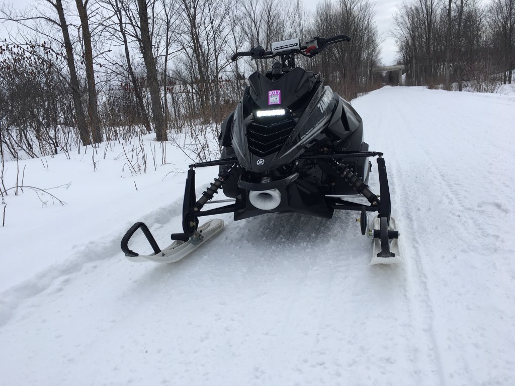

When I first did a air box mod I run a velocity stack with a turbo hose into bottom of air box where frog skin is located, Dropped intake temps down signifyingly,
Dam that’s sweet!
Where did you get those drop
Down front wheels?

They look like the same ones I run. They work great.Dam that’s sweet!
