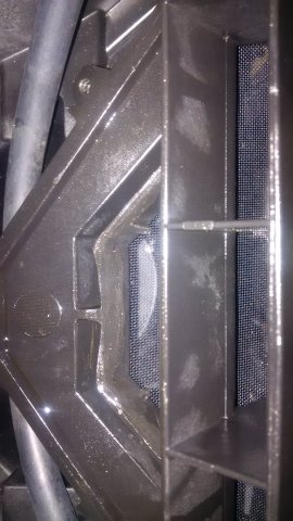

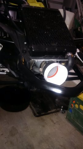

that looks awsome,but wouldnt normal snowdust from trail riding with a group cause to much snow ingestion and cause premature wear to the motor?I already done airbox mod. Today I added a cold air intake from the front of the sled going to the frogskin of the bottom of the air box mod.
I hope this will help

How did this end up working out? Do you have additional pics of the routing to the airbox? Nice set up.I already done airbox mod. Today I added a cold air intake from the front of the sled going to the frogskin of the bottom of the air box mod.

Sorry ZR7000. I don't have any picture cause I sold my Viper. I did the Stringray airbox mod and just reroute the air flow near the lower opening at the bottom with a piece of pipe for more cold air.How did this end up working out? Do you have additional pics of the routing to the airbox? Nice set up.

How much reduction were you seeing?View attachment 151307 I did the same lowers air temps significantly.
