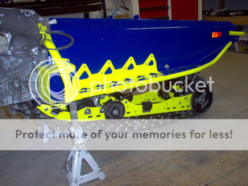

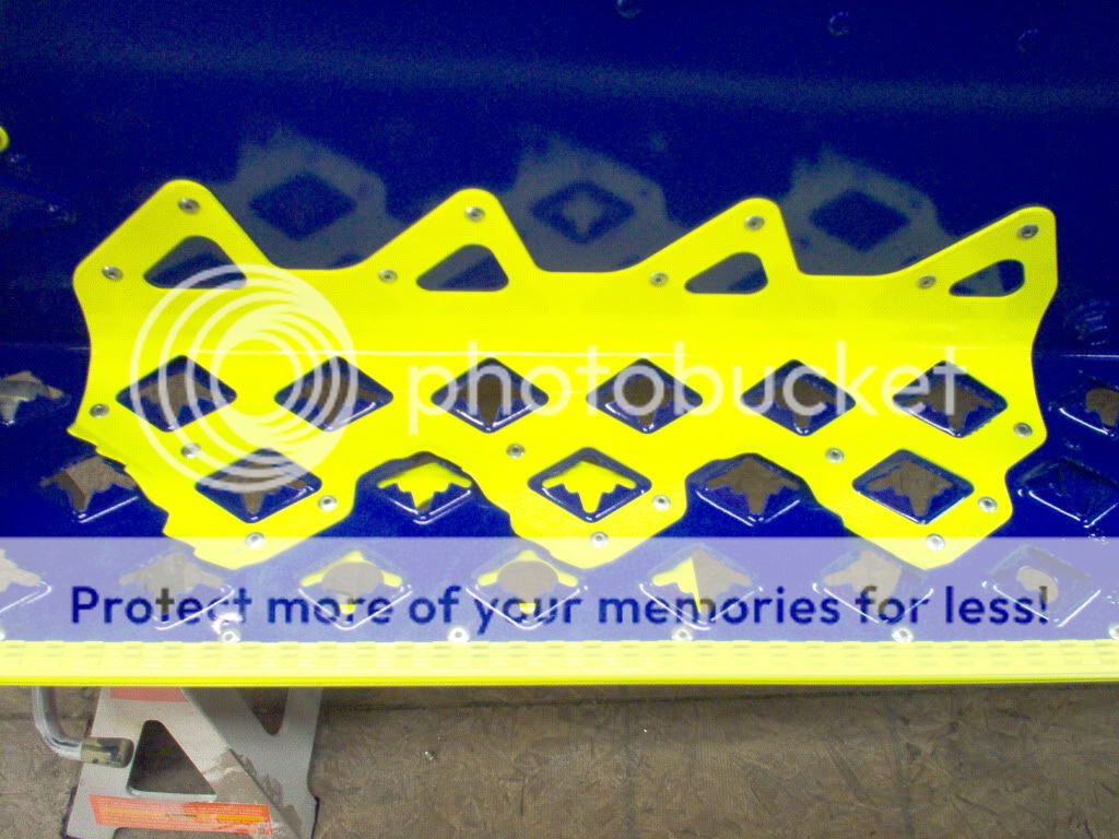

Worked on the sled last night, started in on her around 12:30pm, I really had no bussiness doing anything with it tho, I was too tired and couldn't think strait. lol. The rear skid gave me a pile of trouble, so I called it a night. Woke up this morning and slaped the thing together in 10 mins,(its amazing what a few hours of sleep and a cup of joe will do for a guy) next on my list is to assembile the driver assem, track and skid. Maybe I'll play with it tonight. Here are some more pics for you guys.
A closer shot at the foothold

The rear skid, ready for insertion. lol
I think some Billet wheels are in order, the stock black one just ain't cuttin' it imo. What do you guys think of some oversized Yamaha 6 spokes, anadized blue? looking back I should have powdered all the rear suspention linkages blue :o| I would have liked to eliminate as much black as possiblie.....oh well, I gotta do somthing next summer I guess ;)!

Kinger, there are 19 rivets, 8-10mm bolts, and 2-12mm bolts that hold the bulkhead to the tunnel
