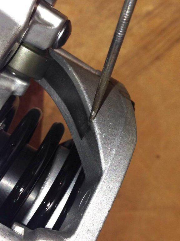

You are exactly right. Had mine apart several times to see what's up. Seventy miles on sled, 2 rollers touch, 1 does not. Took all rollers and pins out, measured them all, reassembled in different positions, still one roller not touching.Kept track of where they came out, inked helix and put back together in 3 different positions. The helix's are way, way, out of wack - causing them to bind on clutch post (like the old Volkswagen jacks). I have done some testing for Dalton Industries (Dale good friend) dating back to 1st RX1's. Dale sent me 2 prototype helix that I never got to run on snow, due to no snow! 1st one installed was YSR 39/35, ran on sled, all rollers touching, scrubs ink off all the way, 2nd helix YSR43/33 again all rollers touch, scrubs all the way. Hopefully we will have snow soon, so we can find out exactly what is going on. I have used Dalton's performance products for years. The quality of these products is the best in the industry. Factory ones look like they were made in a pottery shop. This may be the issue with blowing belts. We need snow for more testing!! John1 mile in the back field, pulled the secondary, notice the pic that doesn't have full roller mark, the roller is free floating and can spin by finger easily at rest! The other two rest on ramp can not spin and shows full roller mark. If I get time going to pull it apart and digitize helix angles,centers and rollers to find out what's the issue.View attachment 124720View attachment 124721

I totally agree the stock cast helix is junk and most likely a issue with this secondary. Another thing I have always wondered with the torsional secondary is - it seems when you twist this spring and "load" it so to speak it seems uneven in the pressure on the helix. It's like it has more pull on one of the post/helix roller when you put it together. Not sure I'm saying this correctly BUT it seems like the rollers touching have a direct correlation to where the spring goes in the hole and is loaded more? I think the spring has a lot to do with what I'm trying to explain. It DOES NOT sit flush/level before you put helix onto it and twist. To me the spring should sit FLAT not angled or uneven in the spring pocket. So the helix has even pressure against the entire surface of top of spring/coil
