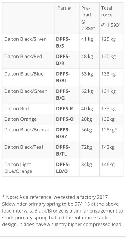

I think that’s a lighter spring than factory right? I could have this totally backwards but wouldn’t a heavier spring counteract the heavier weights? So maybe a black/bronze spring would make the 70g better with a stock setup or ecotrail?Dalton black/red

Yes lighter preload, helps lower engagement. I wouldn’t know about the effect of the black/bronze or a heavier spring.I think that’s a lighter spring than factory right? I could have this totally backwards but wouldn’t a heavier spring counteract the heavier weights? So maybe a black/bronze spring would make the 70g better with a stock setup or ecotrail?

The higher finish rate on a spring increases upper rpms as it takes more clutch weight to overcome. Dalton measured the factory spring at 115 so the black red is a little heavier on the finish but not a whole lot. The preload is lower so engagement will be lower. It is a better spring choice then the factory sidewinder spring as that spring is kinda long and some have reported them breaking. Dalton spring will be of better quality and easier to install being shorter. I personally did not care for the engagement of the black bronze spring...... although close on paper to factory spring I found it engaged a little higher than it should have and was a bit snappy. Your running a fine line with weight choice with stock or tuned and it will come down to belt choice. If your right on the edge I prefer to be on the next lower base weight so you have some adjustability in both directionsI think that’s a lighter spring than factory right? I could have this totally backwards but wouldn’t a heavier spring counteract the heavier weights? So maybe a black/bronze spring would make the 70g better with a stock setup or ecotrail?

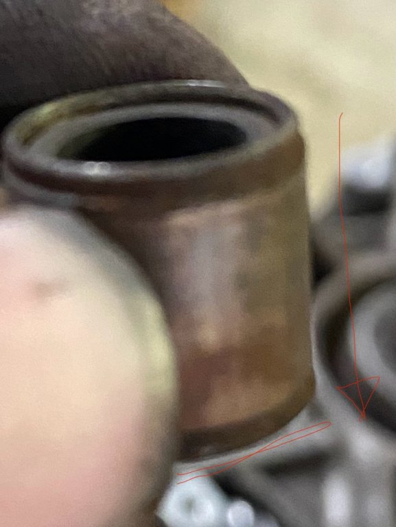

Derailed
So in this case what it seems happened with the Yamaha roller is that the bushing worked its way out a little bit as you might be able to see in the pic and that causes it to bind up. I wasn’t able to roll it with my fingers at all. This caused about 0.006” to wear off the weight but I’ve checked the roller with a digital caliper and micrometer several times if it is out of round it isn’t by much more than 0.001”.
OD was 14.44mm btw, at over 5000 miles with zero maintenance. ID 9.22-9.24mm

IMO, those bushings move just due to the harmonics and back and forth forces inherit in these clutches/engines.So in this case what it seems happened with the Yamaha roller is that the bushing worked its way out a little bit as you might be able to see in the pic and that causes it to bind up. I wasn’t able to roll it with my fingers at all. This caused about 0.006” to wear off the weight but I’ve checked the roller with a digital caliper and micrometer several times if it is out of round it isn’t by much more than 0.001”.
Also, even though that roller is more difficult to spin, I think it would still be moving when the machine is operating. There is a great amount of force against that roller from the weight.
Also of note is that you will almost never see all the rollers and weights wear at the same pace. There is always one that fails first, or is more worn than the others. I believe that could be due to where the clutch happened to be located when is was put on the engine, which could be different every time.
