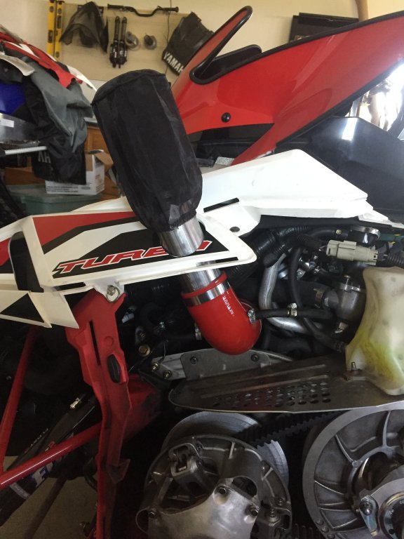

Can it be turned and be an under hood cold air kit?View attachment 129043 View attachment 129042 Here is an out the hood cold air intake for the off trail guys! It allows the hood to be opened up for more cooling and hood removal only takes 10sec longer than without it has quick disconnects on the pcv and intake sensor lines and a wing nut hose clamp on the elbow! Here are a couple of pics!

Gosh,i cant see how the stock airbox weighs anywhere near that,i fact I would almost bet my CAI under the hood,weighs as much as stock,i have my stock box off,i guess I could weigh it.Wow, I wouldn't have thought the plumbing under the hood would be 8 lbs.

Pete, I was seeing 12.8-12.9 AFR on the data logging with the filter out the front of the hood using the Hurricane SMM replacement trail muffler on 270 or 290 tune, with filter inside the hood sucking the warm under hood air was 12.2-12.3 AFR.
Everyone keeps calling them cold air intakes which they are not when they are under the hood, mine is stuffed right into vent screen and the thermometer will read 100 F. right at the base of the filter on a 28 F day. That's the reason I extended it into the actual cold air right out in front of the under hood vent.
