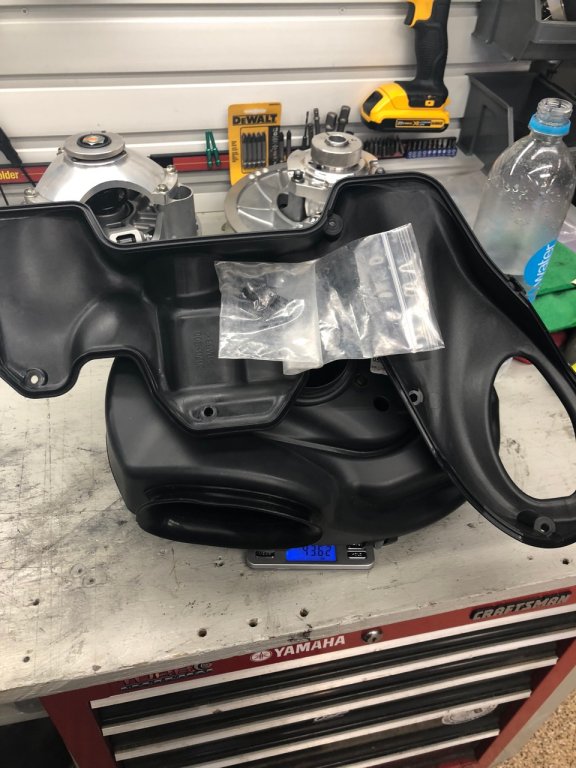

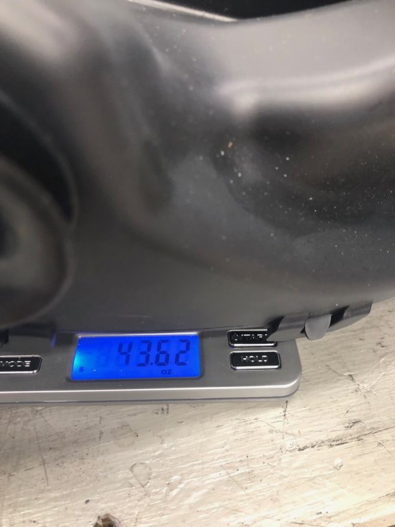

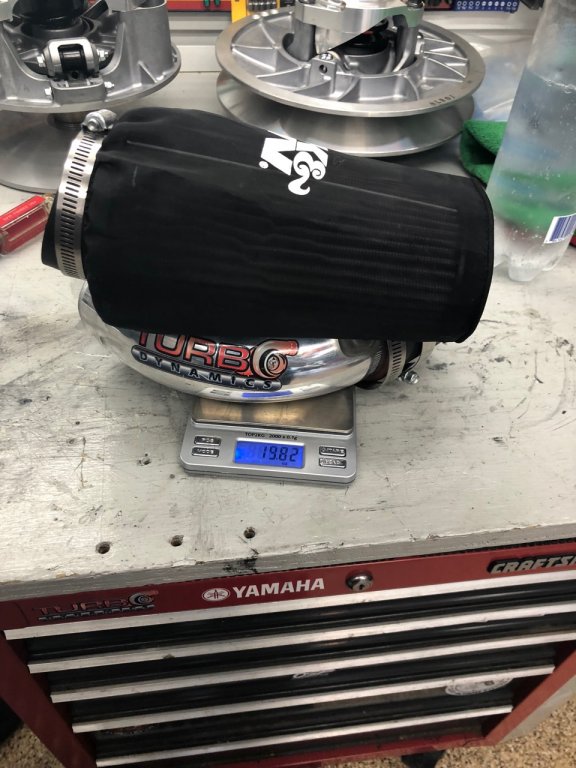

I'm with Knapp on this, let's move on and talk about things that matter.I weighed my hood. as you take it off and it was 17lbs. My apex cr racing hood was 4lbs. There is a plastic tube snake thing under there as the air for the motor comes from behind the windshield then feeds the box on the clutch guard, its screwed on to the bottom of the hood. If you remove that and weigh it supposedly its around 8lbs. I haven't removed mine yet but I will eventually and get a final weight.
Knapp - have you weighed anything or just making assumptions that plastic is same weight as air?
43.62 oz = Stock airbox, filter and plenum (or whatever it is that bolts under the hood)
20 oz = Average CAI setup
23 oz = CAI saves

$200 for 23.62 oz. & warm air.
That's roughly a pound and a half. And warm air.
HMMM.....someone needs to get some cardboard & duct tape & design an actual "cold air" intake......UNDER THE HOOD!
Sticking the filter out of the hood is great in the mountains. It looks douchey on the trails.....
23 oz = CAI saves
View attachment 140356 View attachment 140357 View attachment 140358 View attachment 140359
Thanks!! More fake news on Snowest...
Also agree on hot air intake. Thanks guys
