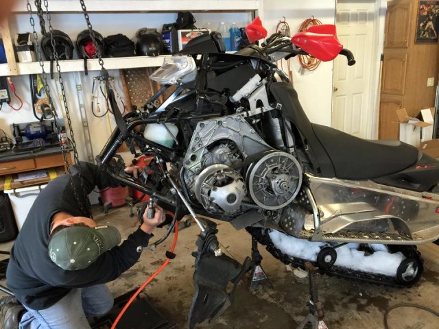

Just got back from spending the day with Grizz, I know have a straight subframe and "Grizz Gussets" installed! I highly recommend this fix! Grizz is truly a master craftsman and his this issue resolved with his gusset kit. Thanks again Fran, you saved my season!! I attached a couple of pictures of the master at work....

Glad to help out. We'll have to get together and do some riding Jeff.
