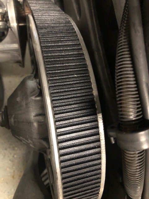

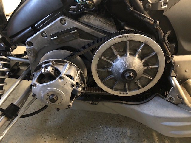

This is all well and good but none of the pic's or video's match my set-up. How about how to change the belt on a 2008 Venture Lite with this style assy.

This is all well and good but none of the pic's or video's match my set-up. How about how to change the belt on a 2008 Venture Lite with this style assy.View attachment 158016 View attachment 158017
Thats why I noted that this video was for external helix Yamaha clutches. I dont have one like yours around to show you how I do them. I set parking break and grab the internal side sheave and roll it back with my fingers as I push the belt down.
