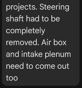

Well, this one could get more involved then expected.
Another member:
Another member:

That probably makes it easier but I doubt that Needs to happen. You can get the factory tube in and out without doing any of that, worst case take the steering loose up top and that gives you a little more wiggle room. That’s only two 10mm nuts.
Doc Harley
- Oct 17, 2016
- 3,714
- 1,815
- 1,413
- Here & there
- '17 Sidewinder LTX SE
Could be?!?! Zero worries.That probably makes it easier but I doubt that Needs to happen. You can get the factory tube in and out without doing any of that, worst case take the steering loose up top and that gives you a little more wiggle room. That’s only two 10mm nuts.
I was wondering why you couldn't just loosen up the steering stem, slip the little 5-in piece in place on the turbo and then come in with the remainder of the factory turbo inlet hose?
I am the best armchair quarterback you've ever seen. Just never made it to the playoffs. Lol
The steering shaft is fixed on a spline end at the bottom. Slides over buy 3 inches. You can take the top bolts off at the column but the post wont move a mm. The bolt that goes through the bottom of the steering shaft is much more accessible without the air plenum not to mention you can get a better look at how much length needs to be cut off the tube. Very simple and doesn't take much time at all. The shape of the crossover will not fit by the steering post. not even close.
Thats on a EPS sled Steve. I don't believe he has EPS.
The top of the non EPS steering post can be jacked up quite a bit to get the turbo air intake tube out.
I gotcha Mike, I hadn't considered that. Makes sense.
