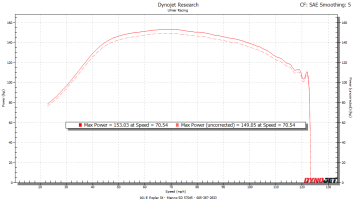

Theoretically the correction factor will make the weather a non-factor when dynoing, but a colder charge temp will certainly make more horsepower.
Here is a graph showing corrected vs uncorrected horsepower.
