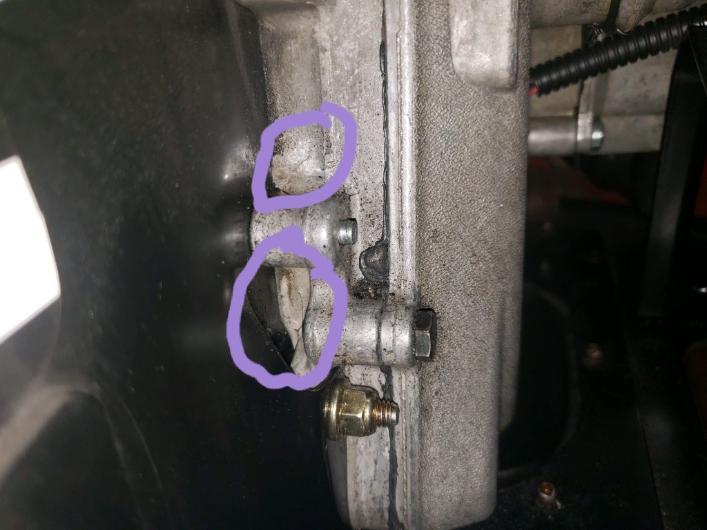

Chaincase cracked and leaking oil.
Have new one on order.

Using the chaincase as part of the chassis, I've felt they were lacking in material here. I've seen a few like this.
gamemaster
where is it cracked?

Above and below the bolt that threads into the case on the aft side.

Yes and below the bolt also.

Both circled areas are cracked.
I just don't get it.
No failure inside case.
Must have been that dang set of g outs that bottomed out the front end at.
Landed in the face of the 4th one at speed.
I just had it happen to 2 winders exactly same area
One with 17000 Km the other with 18000km
Must be what 74nitro said week area and flex also 2 yrs ago happened to another one I work on.
I think with tunnel flex and age this is gonna happen IMO.
