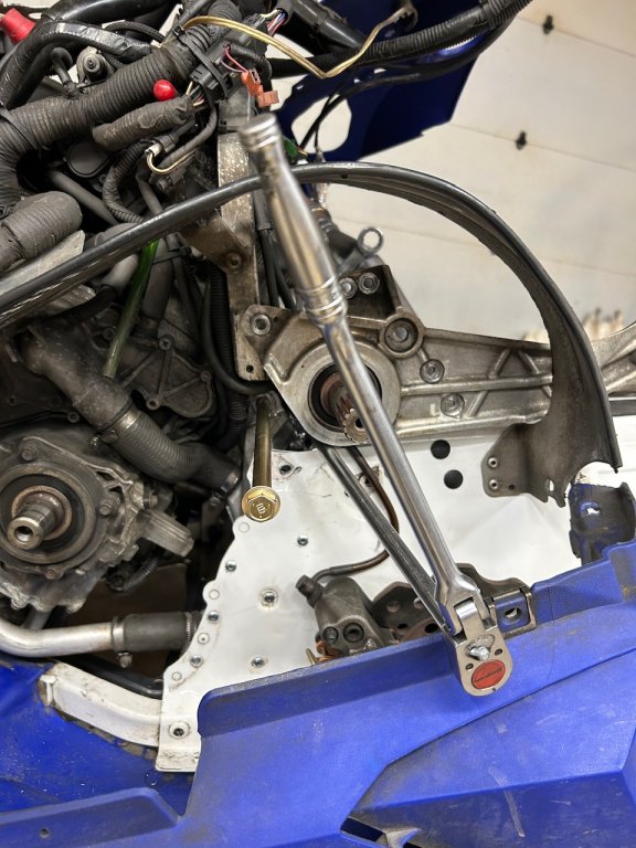

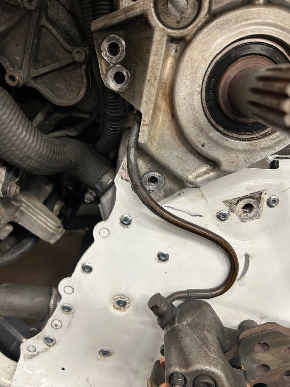

Is the jackshaft support the part that ultimately is holding the engine from lifting higher? I finally got the engine mount bolts out, and I'm now disassembling piece by piece to try and get the engine to liftHere
Valve check?
Man I hope I dont find anything. https://ty4stroke.com/threads/season-over-7k-miles-what-service-should-i-do.153071/ Here we go: Get your sled to this point(should do every season anyway) Remove Plugs(Mine all look same and running about perfect) Remove Valve Cover Use feeler guages to check...ty4stroke.com
smitty_j25
- Feb 2, 2015
- 31
- 38
- Nova Scotia
- 2014 SR Viper XTX
Perfect, I got it disconnected today. The sled is at my in laws so I get very short lengths of time to work on it
