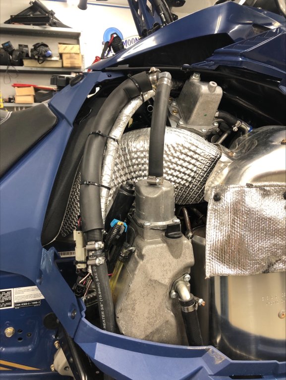

So this is what I did to eliminate the ROV and the line to the air box.
This is the first time I have had to do this, anyone see any problems here? I used a new piece of hose rated for oil from the tank to the elbow and the rest are the original pieces from the factory set up. The lower hose marked " heater hose " was actually the piece from the valve to the air box. Maybe some heat resistant tape?
The only potential problem I see is the 90 degree elbow. It makes a nice neat install but creates a bit of a bottle neck and potential freeze up area in the bypass hose. Most of the bypasses I have seen, including mine, maintain a nice gentle curve radius where the hose changes vertical directions from up to down.
Exactly Bob, The only problem I have ever run into with mine ( one piece of hose looped) was when I had the hose exit by the foot well and one day when pulled over trailside I noticed ice building up on the end of the 45 degree cut end. Contemplating putting a breather filter on the end and tuck it up close to the block so it gets heat while at a lunch break. This would eliminate some of the oily residue by the footwell, however I would be keeping a close eye on it when the sled sits overnight. Maybe even add a short length of clear hose before the breather and connect the hoses together with larger diameter PVC as to not restrict flow.
This is the first time I have had to do this, anyone see any problems here? I used a new piece of hose rated for oil from the tank to the elbow and the rest are the original pieces from the factory set up. The lower hose marked " heater hose " was actually the piece from the valve to the air box. Maybe some heat resistant tape?View attachment 174336
Couple issues that I see. And I speak from experience on seeing a machine here that used a coupler to connect two hoses on the down side.
Like Bob said above, the 90 you used is a big bottle neck, and the second is the coupler you used in the middle of the hose is also a bottleneck. I've only had one sled thru here that blew the tank seal out on it after having had a coupler on it like this connecting two hoses in the same spot, I can only suspect it froze up and took the tank seal out for a second time. Another sled had a hose kink and that downward is close to kinking over time.
I've tried making the hose a 1/2" ID before and it came very close to freezing up, 5/8" never freezes or even comes close to freezing up. Even though the hole in the tank is only 1/2" ID, The fall from the loop on down needs to be 5/8 all the way thru. I learned form Louie Wirbel who installs rain gutters the the larger downward fall needs to be large and free of obstructions to keep from freezing and I believe him.
This is what I have been doing the last few years and it works out great. The 90 1/2" street elbow epoxied into another 90 elbow. Both have the large portion into the stretched out 5/8" fuel line and it makes the corner perfectly. The elbows have the same ID as the 5/8" hose and it runs straight down thru the running board with a 45 deg slash cut to the rear of the sled. Never had any sled done like this freeze up or have kinked hoses.
