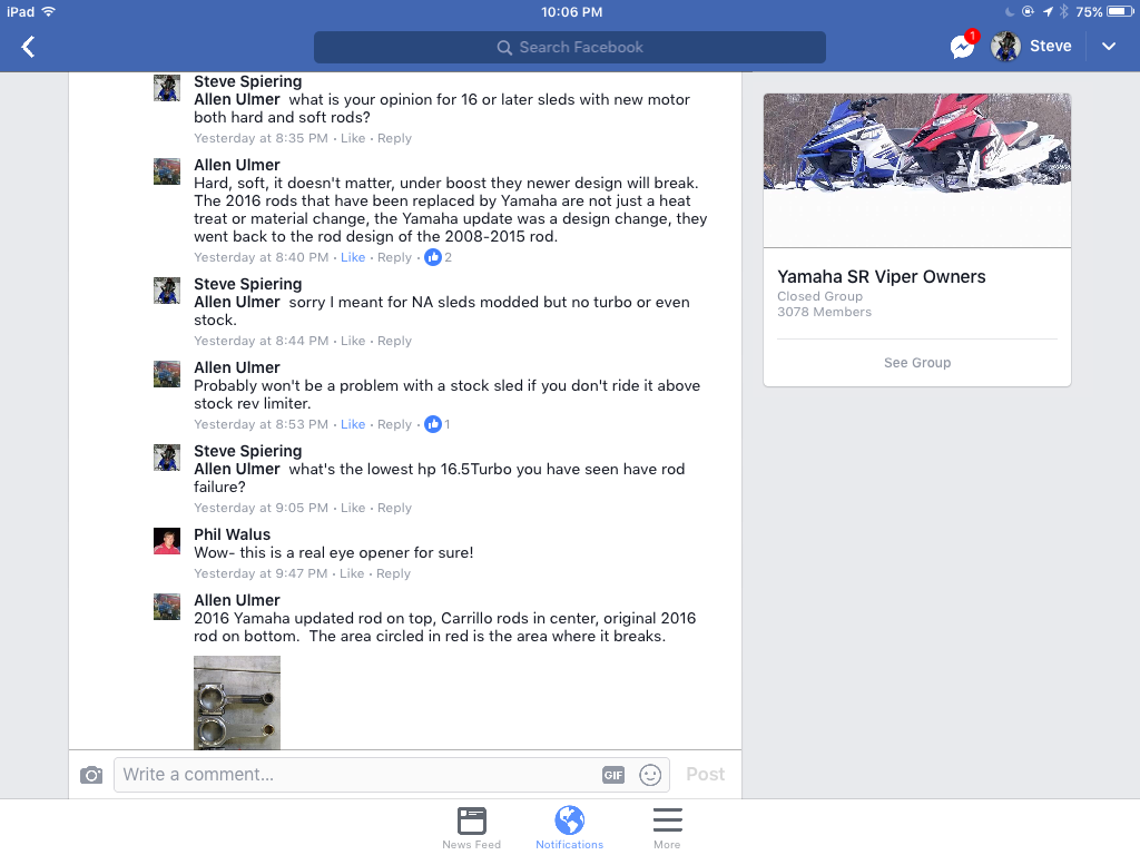

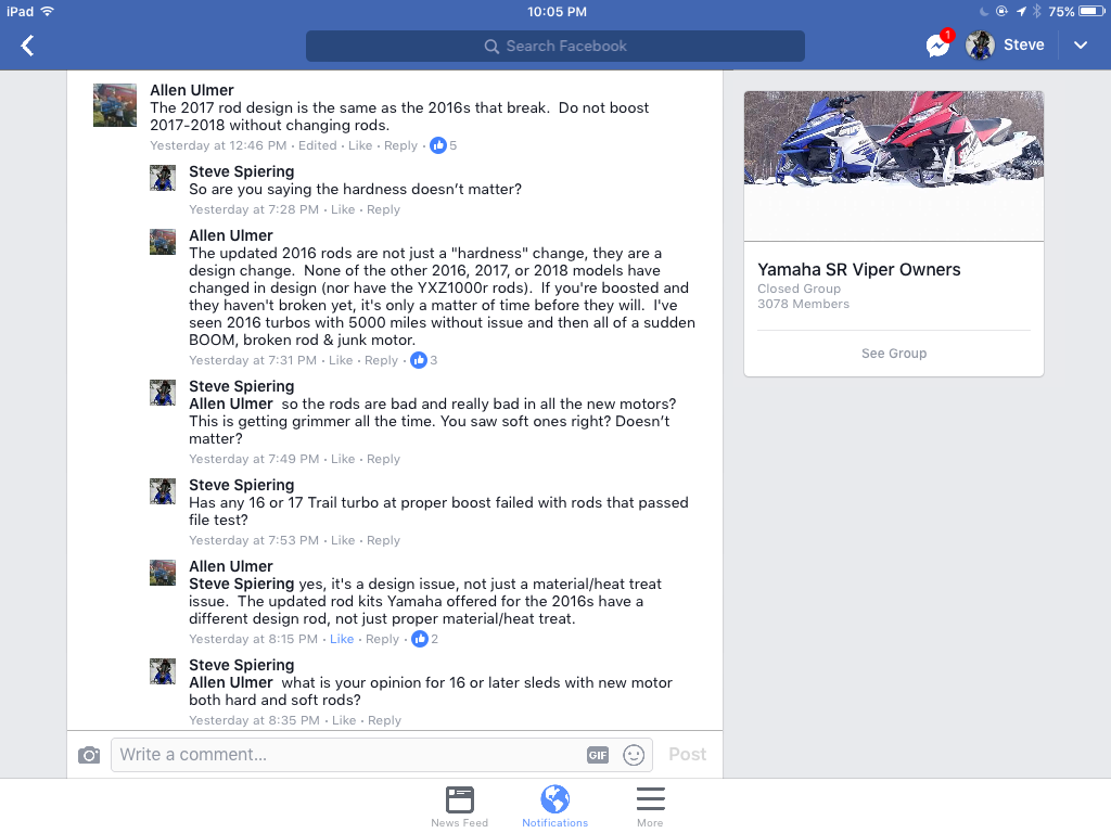

Here is what Allen posted on Facebook.
I wish it were like the old days when Yamaha themselves was on top of things like this and talked to the techs and dealers in a timely manner. All we all can do now is get all the info we can and form our own opinions.I was not to concerned when I got my 16 because I had no plans to turbo it but I did get the dealer to throw in 4 years of YESP. If I haven't broke one by then I don't think I will. Is upsetting that if it is a wide spread problem it definitely hurts resale / trade in value.
All you owners of the new engine should carefully read the statement Yamaha released after the new engine was in customers hands and questions arose. Obviously the quality and durability statement has for sure been found to be false at least as far as rods are concerned.
