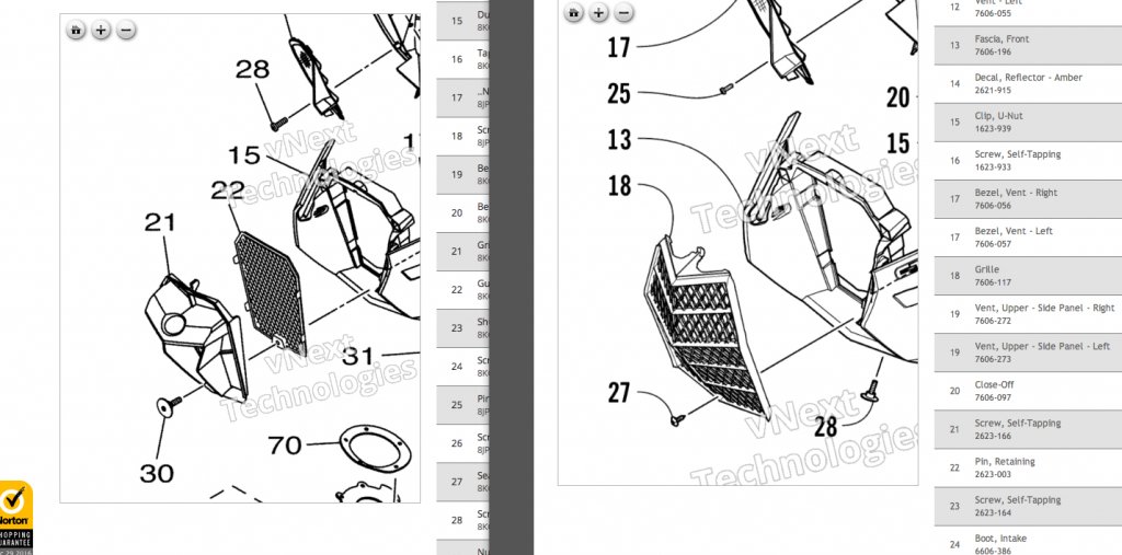

So with the cat screen it helps?
Sent from my iPhone using Tapatalk Pro
Yes it help with cat screen !!
#18 The shape of the screen is like the front of a boat , and the hole in the screen look bigger, it help a lot .

SW MTX on left. M9000 on right
Looking closer at my sled I'm not sure adding a grille is needed. I think I can probably just glue the Frogskinz around #22 and put it back in but #18 looks like a better shape to deflect snow.
you and I are on the same page...your microfishe posted...the only thing is the grille on the king cat (which you refer to) you lose your nose piece....if you look at the king cat head on Im not liking the stubby fat nose look....Im assuming we have part number 22 already and you are thinking of frog skin over it?

Yeah I noticed that it looks like the part that I ordered number 18 is not going to easily snap into the Yamaha and part.you and I are on the same page...your microfishe posted...the only thing is the grille on the king cat (which you refer to) you lose your nose piece....if you look at the king cat head on Im not liking the stubby fat nose look....Im assuming we have part number 22 already and you are thinking of frog skin over it?
We won't know until it shows up in a take it apart no matter what I'm definitely wrapping the nose with frog skin. It may be that that piece just needs to be cut a little to fit in and create some sort of retainer for the top
#18 from cat looks to replace yam #21 and #22!

I ordered the screen from Cat.
you mean part number 18 ? you do realize that you cant run it with your nose piece...it replaces the yam screen and nose piece...look at the m9000 king cat nose
