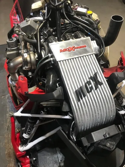

MCX has one as well.

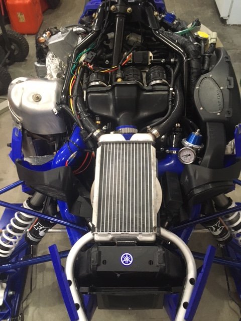

I have, it's the best value in snowmobiling. They have an additional injector port they need to block off and you'd have to reroute the Bov, as theirs is included with IC and cannot be altered.MCX has one as well.

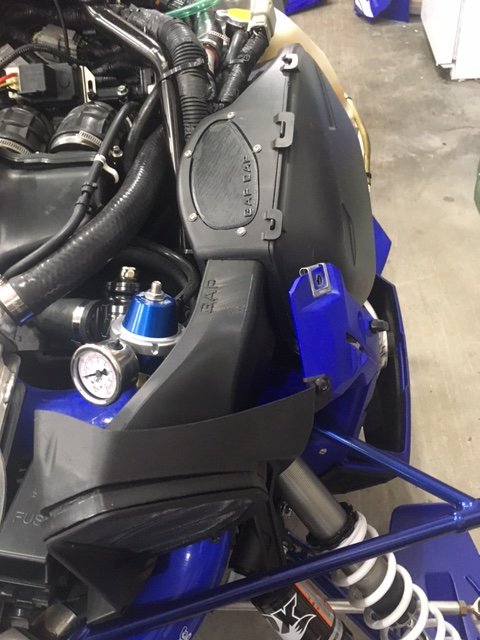

Although I feel an intercooler is effective and necessary for our turbo sleds, I think rather then increasing the cooler's size, first its more important to ensure the intake air that the cooler is temperature managing is as cool as possible. In the snowmobile world we are very fortunate to have access to cool ,normally well below freezing temperature, and dense air for our engines air intakes to use.
IMO a true cold air intake to feed the air passing through the intake system is the simplest and most effective way to control intake temps and enhance or maintain engine performance. A cold air intake with a little ram air effect is even better.
For my application I have chosen to go with a true cold air intake, enhanced engine cooling capacity, and full venting to keep all temps as low as possible.
