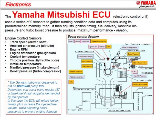

It may not, but the ECU already will - Yamaha added in a specific tune for 87 octane for times when you may not have access to 91 octane (lower left text box in the image below).
I though that image was an early '17 draft and it was clear that the knock sensor isn't used in stock form. It has to be activated which Hurricane and TD did lost of testing early on to get right.
