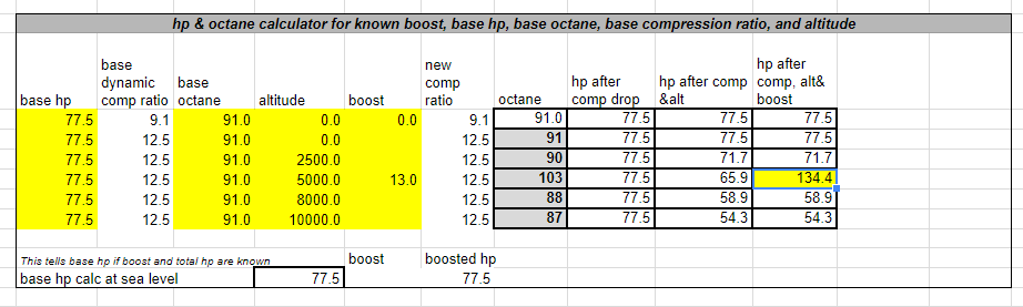

To assist in my decision making on the shim/no shim/single vs double head gasket, I took the compression and octane calculator from the sticky in the turbo section and tried to create one for the phazer. Using the 12psi at sea level on pump gas setting from MCX, it seems accurate enough to give some ball parks for octane:
The problem is that there are a very large amount of people who pull the shim out and just run with the stock head gasket at elevation because it becomes too doggy on the low end. There are countless posts of people running 10 psi on 91 at 10K, and @yamahajohnson220 is running 14psi on 100ll. But when I plug that value into the calculator it tells me that it should be closer to 98 octane for 10 and 102 for 14. Im not sure if the calculator is off, or if the OEM knock sensor pulls timing allowing this to work on 91 at 10 and 100ll at 14.
The hp calcs also seem off. MCX claims 140hp at 12psi. There is a dyno result on here showing a phazer making 161hp at 14psi with the shim (110 octane @ 4500 feet) and 161hp at 13psi without the shim and much better bottom end response. The calculator is showing only 134hp for those values
My goal is 96 octane, which if the calculator was correct, would be perfect for 13 psi at 10K with double stacked gaskets.
I have pretty much decided against the shim at this point. I'm just struggling with a single or double HG.

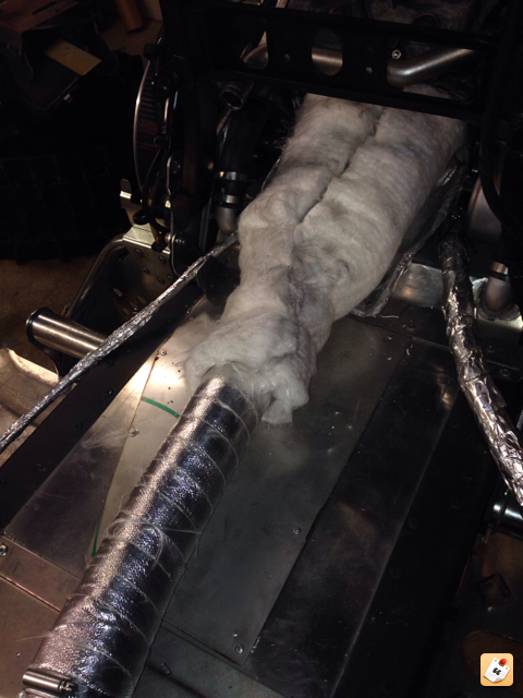

@kallholmen - I was just reading through your build thread for the first time in a very long time (BTW google translate makes it a hilarious read!) and I had a few questions for you. I was going to PM this, but I realized maybe others could benefit from the response, or possibly have some other solutions.
1. What is the material you used to wrap the manifold/header? The white, thick, insulation-like material over the top . I will have heat wrap on my header (again), but I was thinking about adding this stuff over the top of that instead of wrapping every coolant hose and electrical line in reflective heat tape that just seems to degrade over time.
2. What did you use on the intercooler to paint it black and how has it held up? I was going to have mine done in black thermal dispersant coating at my powdercoater but they want $80. I'm still leaning that way but if there is a more economical option I am open to hearing it.
