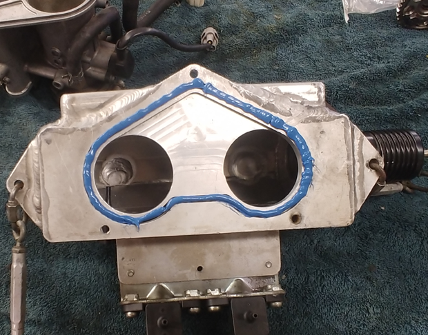

On Sunday I tackled the intake manifold issue. The Boondocker intake was screwed onto the manifold with one rusty machine screw and two self-tapping screws that were not holding very well at all. It was also extremely hard to get to the heads of two top screws to remove. I dug through my bolt collection and found three anodized philips head machine screws. I tapped the throttle body mounting locations to allow a more secure connection, and easier installation/removal of the screws. After the 3 bar map sensor from the PCV-VTI was mounted, I put some RTV around the o-ring for the Boondocker intake, and secured it to the throttle bodies.

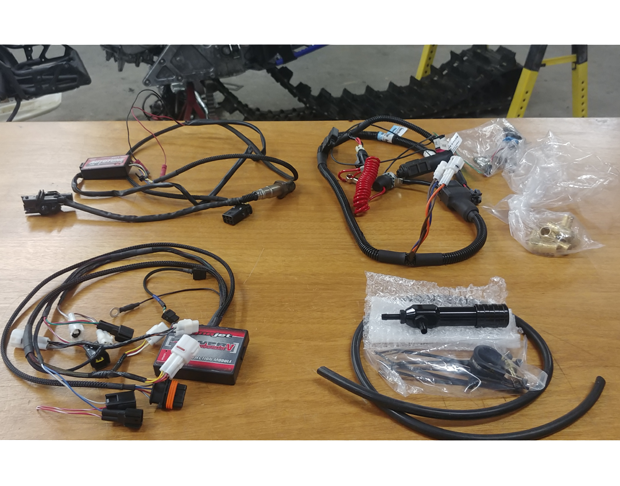

I also needed some type of roll-over-valve system. I wasnt sure if any of the kits out there would actually work with the boondockers oil can. Bill (@Mtnviper ) responded to a thread I created about it, and it seems like his Four Stroke Solutions kit for the Phazer might just work. The biggest concern is mounting the actual valve, since the room under the intercooler is limited and the valve is best mounted at a 45 degree angle. Bill says a few 90* fittings should be fine, so I ordered up one of his ROV kits and some misc 90* fittings, hoping to be able to mount it right behind the filler neck.
In doing some research, I found that the only way to do any datalogging with the PCV is via the POD300 display unit. Considering I wont be able to get this thing dyno tuned, and I am shooting in the dark as far as figuring out if I can get 550cc injectors to work, I made the decision to pick up one of the displays as I know I would end up sitting out in the mountains on our trip regretting that it if I didnt do it and was having issues (if I actually have this thing together in time for it!). I already have enough stuff to cram in my avalanche pack and tunnel bag, having to drag a laptop with doesnt sound too appealing!
As much as I would prefer true gauges over an LCD display, I decided to pull the wideband and (brand spanking new) boost gauge since the POD300 will display those values, and can be programmed to show warning lights for just about any value. Now I get to try and put all this stuff, plus the POD300, into the already very crammed and messy wiring of this thing.

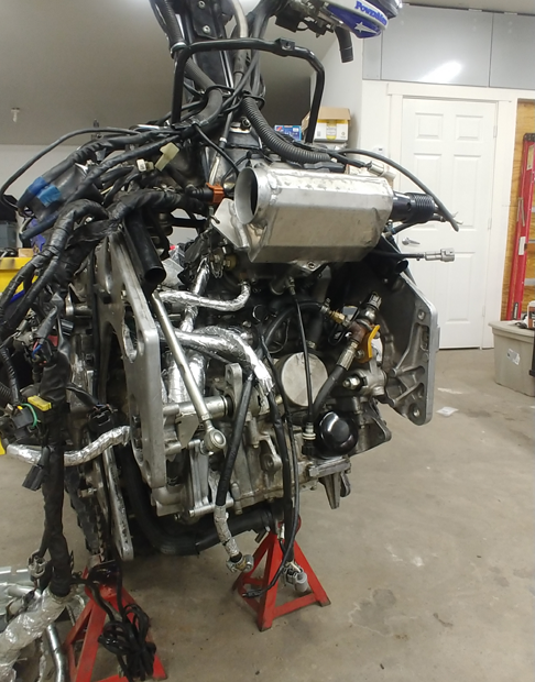

The pod arrived, and it was time to get all this stuff crammed into the sled. One of my biggest pet-peeves is messy electrical and/or hacked harnesses. I knew this particular part of this project was going to test my ability to tolerate a rats-nest of wires. There just isnt a lot of room to work with on the phazer, and I dont have time to shorten, solder, and heat shrink dozens and dozens of connections with the clock ticking away before our trip. From here on out, the restoration-style of this project is going to transition into a get-it-done style until the off-season.
I started with installing the PCV-VTI, and ended up locating it on the opposite side of the recommendation from power commander. I re-purposed one of the quick connections I made for the gauges to provide power and ground to the Autotune module. Since I deleted reverse, the "drive" indicator needed to be grounded to force the sled into knowing its in forward gear. I couldnt bring myself to cut that connection, and I didnt have any bullet-style electrical connectors, so my solution was to open the case for that connection, wrap the wire around it, and drop a small amount of solder onto it. If there is ever any reason this will be converted back to having reverse, it will just require the person to unsolder the connection and pull the wire out.
The whole time I was working on electrical items, the skid was staring at me with this creepy, stalker-like look. It knows how much I want to get it installed, and its just taunting me. It reminded me of that "soon" meme. At one point I turned to it and yelled "STOP STARING AT ME SWAN!" I think I have been spending too much time alone in the garage without human contact...
Once the power commander items were installed/wired, I moved onto the ROV kit. The Four Stroke Solutions kit was very well made, and I can see that if I had a standard oil reservoir setup, it would be an extremely easy install. However, since I have that goofy Boondockers oil can with extremely limited space above it due to the intercooler, this became quite the chore. I must have tried at least 20 different variations of hoses, fittings, lengths, and placements. I ended up with this ugly mess of hose clamps, copper fittings, and hoses that allowed me to actually have a slope back to the oil resi, the valve as vertical as possible, and clearance for the intercooler to go over the top.

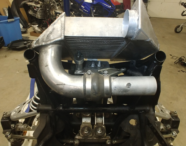

Then it was time to start fitting all the turbo parts together. I realized I still didnt have the wrapped turbo pipes sprayed, so I started putting coats on in between doing other things. I ended up with 4 coats on the midpipe and downpipe. I still have yet to re-wrap the manifold and I am not looking forward to doing it. That stuff is itchy! I also clamped the tunnel cooler lines down. While doing so I realized there was no line for the gas tank overflow/vent at all! Considering that the vent is located right above the turbo manifold, this obviously isnt the safest situation. I once again stole something off the 08 and installed a vent/overflow line.
When I first got the sled, the IC was sitting at a strangle angle and the front of it wasnt even bolted down. The PO said it was like that because he did a crappy job aligning all the hoses and connections after replacing the starter. That seemed feasible enough. I loosely bolted the battery box and turbo back onto the side of the machine after cleaning up the bulkhead a bit, and started doing some test fitting. It was really hard to measure and get pictures of, but the flanges where the IC connects to the intake are just too damn wide. Even with them completely touching, the IC sat off to one side a over 1/2"! In order to see it in pictures you need to look at the sides of the IC in relation to the sub-frame rails, and the front mounting bracket in relation to the center of the cooler.
I really wanted to take it over to my buddies place and cut some of the flange down on his bandsaw, but it was out of commission with a severely bent blade. My other buddy with one has to get up very early in the morning, and since it was starting to get late, I didnt want to bug him. I ended up stuffing the intake with paper towels, installing a clamp around the flange and marking it with a sharpie all the way around. I then took a grinder and worked my way around until there was only a hairline of a mark remaining. I sure hope that will be enough surface to clamp to! Its still 1/4" off-center, but there isnt any more I can do short of trying to find if anyone makes some specialty skinny-width clamps or something.
If I set the cooler into place and lined up the intake, the connection to the turbo was off by about a 1/2" (it was impossible to measure). The quality/quality control on this 'kit' was horrible. Its bad enough that the IC makes the Phazer have a face only a mother could love, couldn't they at least make it fit?!?! I placed yet another order for a 1/2" offset silicone hose, and while I was at it I tossed in a black replacement for the baby-blue cooler-to-intake connection.
Before I bolted the sub-frame into place, I wanted to finalize the vacuum line connections just in case there was something that would be easier to route with out it installed. In doing so, I pulled the BOV off to see what fitting I would need to convert it to 90* so it wasn't sticking straight out the side of the sled. That is when I discovered that the piston in it was seized. I gently removed it by pounding it out and inspected the piston and spring. The piston could be polished and lubed, but the spring free length came out to 56mm. Replacement spec is 67mm!

Looks like she's coming right along! I suspect that there have been a few long nights in the garage!
BTW the ROV valve placement should work just fine.

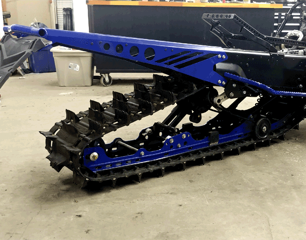

With nearly 24 hours of cure time on the paint for the right setback plates, I got the skid completely installed. I didn't install the 2 wheels that go on the outside at the tip-up, still not sure if that is a bad idea or not.
The turbo install was kicking my arse. With a fresh head, I realized I need to start from the head and get the manifold bolted on tight, let the mid-pipe end up where ever it ended up, and work my way forward. In doing so, the turbo ends up no where near where it would need to be for the bracket to bolt to the frame, and the bracket is part of what holds the turbine housing on. Frustrated with dealing with this situation I decided to just move onto something else for now. The adaptor for the BOV arrived, and I wanted to see just how much I need to cut it down. In order to do so I would have to set the tank & panels in place, which provided a much needed motivating tease of how it will look once I can finally bolt things in place!

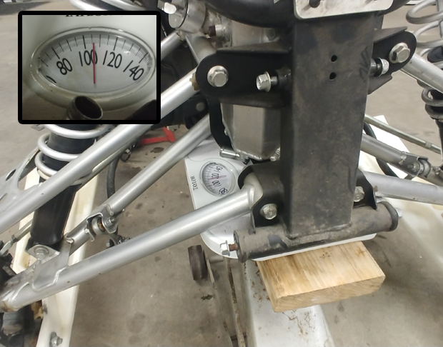

If I get those arms coated in blue, slap some floats in place of the stock shocks, and treat the IC with heat dispersant black coating (and maybe the sides of the cooler in blue as well) this thing would actually look pretty damn cool IMHO.
This is when the Curse of the Crooked Cooler© and turbo alignment issues once again reared its ugly head. If the intercooler is centered on the machine, it sits too high to mount the headlight!
I took a step back in frustration of how absolutely lousy this particular Boondocker kit is, vowing to never ever purchase one of their products as long as I live, when I noticed there seemed something off with the tierod.
That is a different part number than the tie rod from the 08 (I assume its shorter), so I cant swap them. I found the closest place that had one in-stock and ordered it up, then took a night off of wrenching and took the wife and kids out to dinner and a show, only to return to this email.

Sounds like you could use a lathe at the moment! A new tie rod would be an easy one to machine (as long as you can get left and right hand taps) though you may be able to straighten the original enough to be functional, since the bend is rather slight.

when i converted my 09 rtx into an xtx rear suspension i used a kimpex kit for adding wheels and axle to an older enticer suspension that i modded to go in between the rails instead of the outer wheels. it held the plastic off of the floor about 1/4" and the slider wear looked good at the kick up the last time i looked at it. without them i bet you will wear through.
