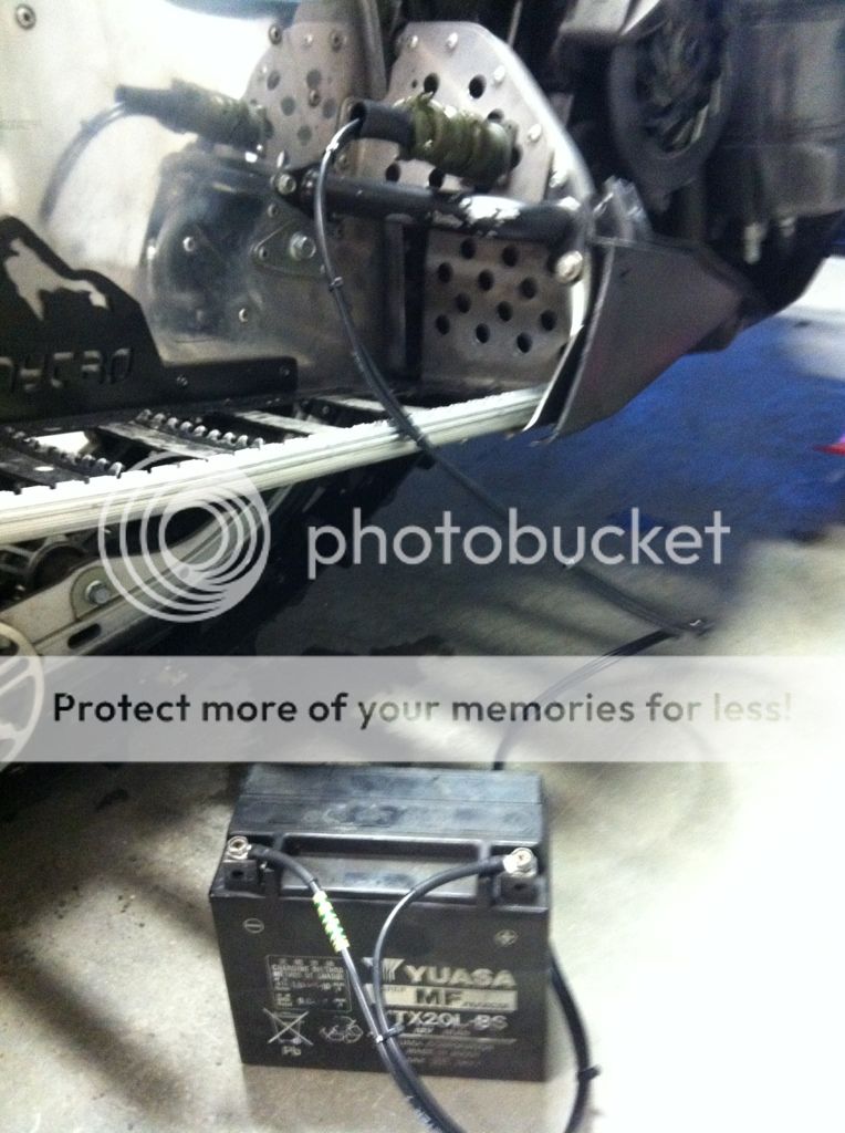

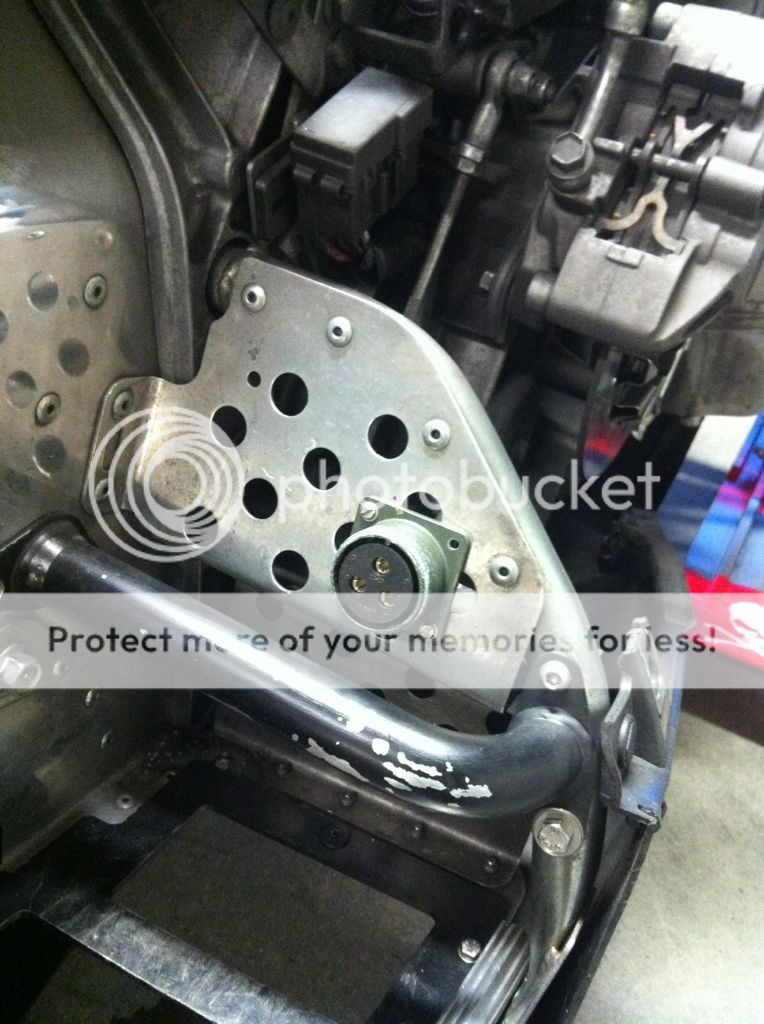

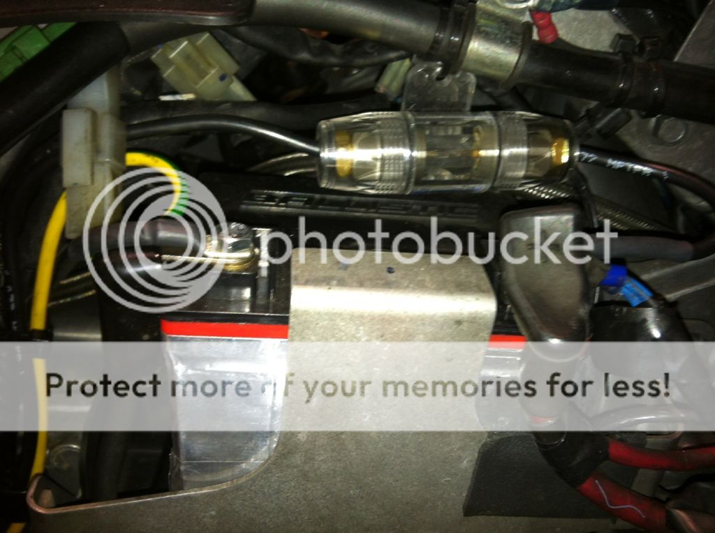

Was working on the sled today and got an idea for those really cold days…
