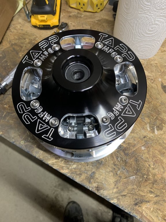

Justinator, do you have a weight on that?View attachment 159077
Got this beauty in last week. 110% satisfied thus far. Extremely easy to setup and incredible belt grab. Clutch runs so cool its almost unbelievable. Worked a bit this week on measuring /verifying/achieving correct offset. Will try and find some time this weekend to continue testing some different helix/spring combos. Its an expensive purchase no doubt but I have zero regrets on the purchase. The quality is unreal and fast to make adjustments. Great addition for the winders.

You mean total weight of the clutch or what Im running for weight in the clutch?Justinator, do you have a weight on that?

Total weight of Tapp clutch ?You mean total weight of the clutch or what Im running for weight in the clutch?

No sorry I never weighed it before install.Total weight of Tapp clutch ?

No problem. Inquiring minds.....lol. But it looks light...

I'd bet it's heavier.
It's stout with 4 arms compared to 3
