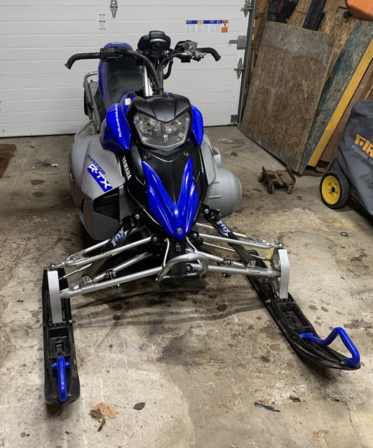

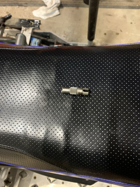

[/IMG] First post on the forum hello from Canada Bought a 2008 rtx phazer that was throwing a #30 code. Brake lever and emergency stop button were broken which led me to believe that it was a roll over. Read up on some of the other posts concerning the issue with no success trying to pressurize the oil tank with compressed air. Also tried using a suction device on outlet oil line...nothing. Frustrating. Should have just hooked up an oil pressure tester right away. Thankfully being the self-motivated determine guy I am decided to rip off the subframe/oil pan after finding these instructions on this post. On top of dealerships beening swamped with sleds for pre-season servicing.
Well, found out that the oil pump gear driven shaft was broken. That explains a lot! Just ordered one from Alberta as Yamaha is all sold out and on back order. Going to be doing Loctite starter fix while everything is off.
Should I be replacing o-rings on the oil pump?
Thanks for the knowledge and becoming a member on this site.
Welcome! Good to hear the info is still being used. Are you going to check the bearings while in there?[/url]![]()
