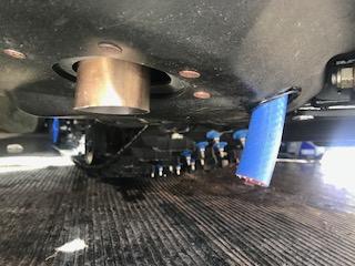

Vent that hose that goes into the air box to the atmosphere and run it out the bottom of the belly pan. You won't have anymore problems with oil in you sir box.

I've already ran a high temp. hose from the separator tube that went into the airbox down through a hole I drilled in the plastic about 4" behind the muffler and put a plug in the grommet that is in the airbox.I would guess any vented catch can would work . Just reroute from the separator to the catch can and plug the hole in the airbox.

I had big problems with my nytro filling the air box with syrup like slop, it would drip and run down the engine. For awhile i thought i had engine issues. Once i bypassed that vent to the belly pan the intake stayed clean and bone dry.
Did the same on the SW, and have no issues there with oil/moisutre on the intake or intercooler.
