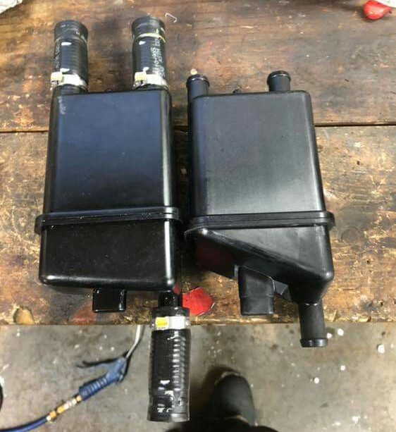

I found a picture of the new updated oilseparator. The right one in picture. It better to drain out moisture.

Don't forget to clean that box out every year when you do your oil change. It's always venting to atmosphere so with the hot and cold cycles throughout the season it's going to collect moisture no matter what. Take it off and spray lots of WD-40 in it and a bit of compressed air back and forth and watch what comes out. If you're using a rollover valve same procedure on that while you have everything apart. Oil, oil filter, chain case service , airbox cleaning and rollover valve cleaning at the same time yearly!
Good advice! For Oil Seperator I just use some Dawn Dish Soap and hot water. Let it dry out after the air lightly sprayed. That thing is disgusting everytime.Don't forget to clean that box out every year when you do your oil change. It's always venting to atmosphere so with the hot and cold cycles throughout the season it's going to collect moisture no matter what. Take it off and spray lots of WD-40 in it and a bit of compressed air back and forth and watch what comes out. If you're using a rollover valve same procedure on that while you have everything apart. Oil, oil filter, chain case service , airbox cleaning and rollover valve cleaning at the same time yearly!
