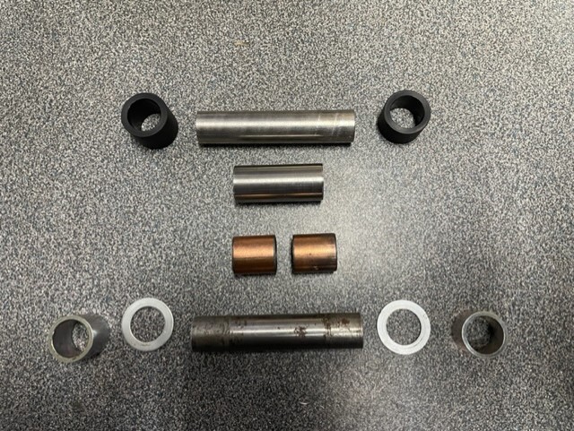

I now have a handful of kits in stock. Retail is going to be $150 per sled. Only notable change to kit is I opted for a plastic instead of stainless offset spacers to help keep costs down. All the vipers/sidewinder use plastic. I also increased the OD of the offset spacers a bit and lengthened them to eliminate the thin shim washers used with the OEM setup.

Do you have a diagram on how that goes? I think I'm kind of in a mess I created myself couldn't get stock bushings out tried drilling at 18mm. I think I'm going to have to make my own kit oversize to 20mm-16mm sleeve now. These spindles are awfulI now have a handful of kits in stock. Retail is going to be $150 per sled. Only notable change to kit is I opted for a plastic instead of stainless offset spacers to help keep costs down. All the vipers/sidewinder use plastic. I also increased the OD of the offset spacers a bit and lengthened them to eliminate the thin shim washers used with the OEM setup.View attachment 173987

Is your kit direct fit for my 2012 FX Nytro 121" with Curve XS ski's?I now have a handful of kits in stock. Retail is going to be $150 per sled. Only notable change to kit is I opted for a plastic instead of stainless offset spacers to help keep costs down. All the vipers/sidewinder use plastic. I also increased the OD of the offset spacers a bit and lengthened them to eliminate the thin shim washers used with the OEM setup.View attachment 173987
