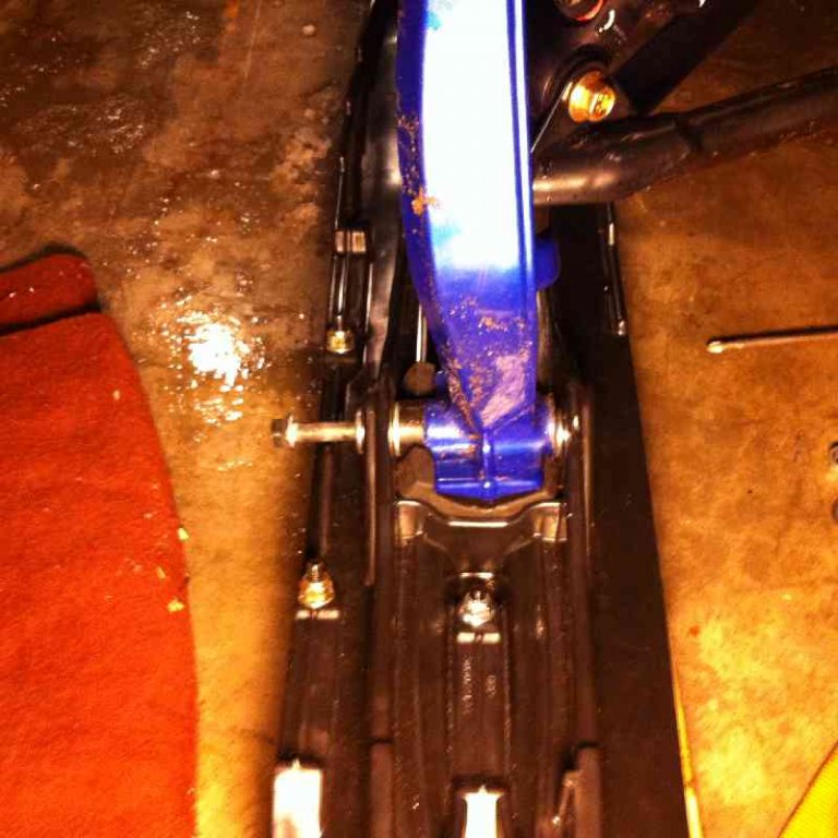

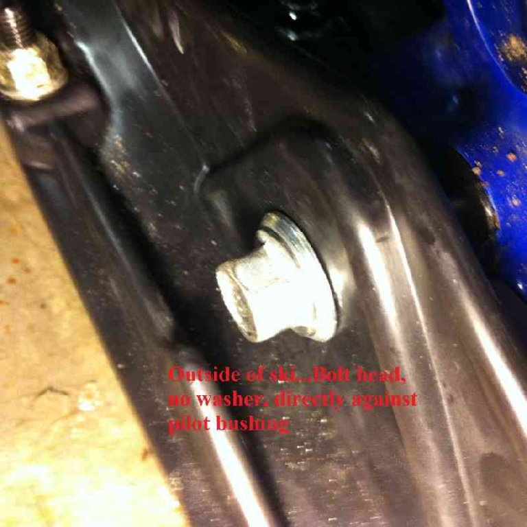

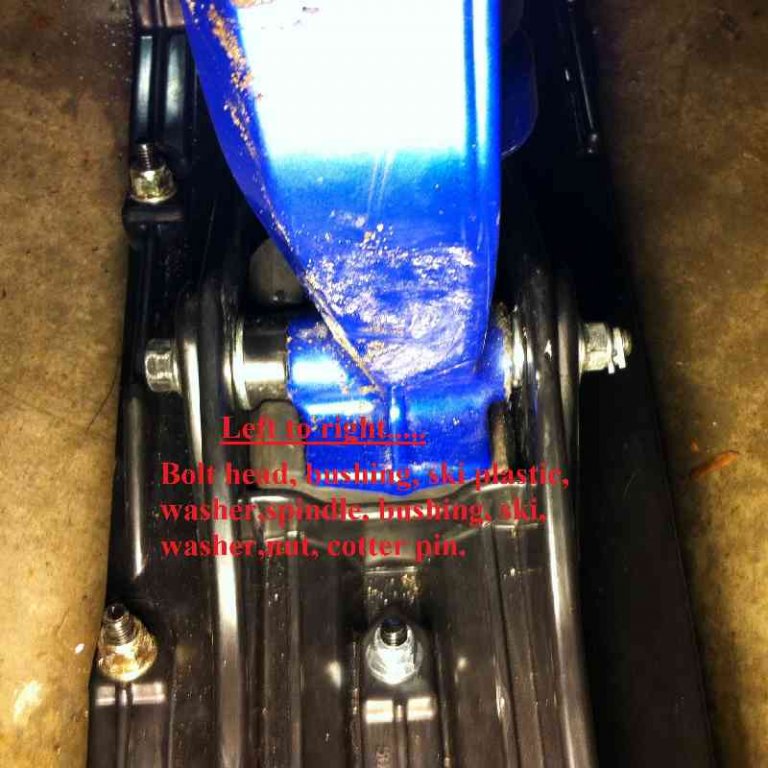

SW main ski Bolt and washers:
Now that we have the OUTER bushing reinserted, we can change the washer setup on the ski bolt install....
We need to do this cause the spacing after the bushing change, still is not exact and additionally, now that we have changed the outer bushing, we want a shoulder INSIDE that outer ski plastic, between the SW spindle and the plastic ski(since the bushing shoulder is now outside) so it does not wear on the plastic.
From outside to inside: Bolt, Bushing, Ski, Washer, SW spindle, Bushing, Ski, Washer, Nut, cotter pin.
Dan

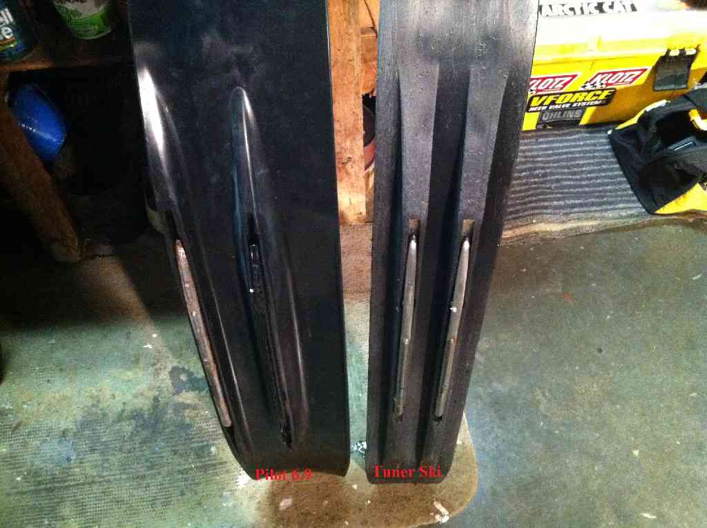

On my current 1200 4tec doo, which is ultra rider forward XS chassie, I decided to try out the pilots but this time in the 6.9 version, as the extra flotation is really welcomed on the 4tec with the extra nose weight being an extreme rider forward design, and the results impressed me. Not only incredible in powder making the 4s feel fun and playful(2s like) but also being even BETTER on trail then the 5.7, as the 6.9 has a wider unique distance between the two carbides when compared directly to the ultra popular 5.7 pilot.

The handling I felt needed work, being nose heavy and steering that was far too heavy, and little to no transfer(no studs yet either). I immediately thought of the 6.9s to make this chassie steering feel better.
So Tom ordered them up, St.Onge happened to have a pair there so we got all the goods needed, as I had all the part numbers and specifics. I will try to include all the info here as Ive got quite a few PMs both here and on DooTalk on this setup. I took a ton of pics of every step, along with going over the entire sled with fine tooth comb since I may become an owner of one....quite a nice package here, and you can see yammies hands are all over this new gem.

Another great thing about this setup, is it not only is the best setup overall IMO, but also is by far the cheapest when compared to aftermarket skis. BRP dealers can now order them again as they have become an available item after being discontinued....Here Leaders sells them on ebay:
http://www.ebay.ca/itm/Ski-Doo-New-...32c2694:g:-Q8AAOSwUuFWzTeM&vxp=mtr&rmvSB=true
I run 5" BRP "extreme bars on my 1200 setup which works well, we got the larger 7.5" executive series as this chassies does not suffer from the quirks of the XS DOO chassie and seems to do well with more carbide where the doo does not. The extremes will work well too no doubt, but Tom opted for the 7.5"(BRP calls them 8")
I nearly forgot the conclusion....after many adjustments to alot, this new LE LTX now feels like I added EPS, and is NOW simply a pleasure to ride. Absolutely the best improvement to this chassie is to drop the stock ski, and slap on some pilot 6.9s, your arms and wallet will appreciate it!
