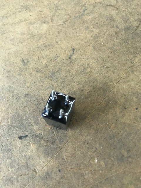

Rock starts with a "sealed" relay and takes it one step farther with an epoxy to ensure it keeps moisture out.
They are $20 each. I will have them up on website soon.

The pic of the Ulmer relay looks just like the Polaris relays I have....
It is. I just ordered two last week and when I pulled back the black tape it says Polaris right on it.
