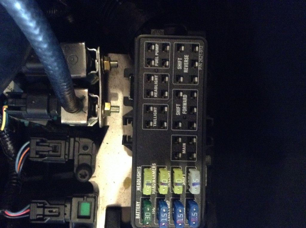

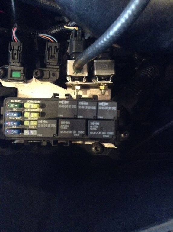

It's really simple, take your hood off and open the fuse box. You'll see the relays, if you pull them out it says what they control under neath. It's not 1 relay per say that may give you trouble, it could be any of them. It's really worth guys having a look at these so your familiar with the location so when it's 30 below you know right where to go. Last year I just brought them all inside, if I remember correctly they are all identical. I'll take a picture shortly.Hey Dan..... now that you have a sled,could you take a picture of the relay in question?

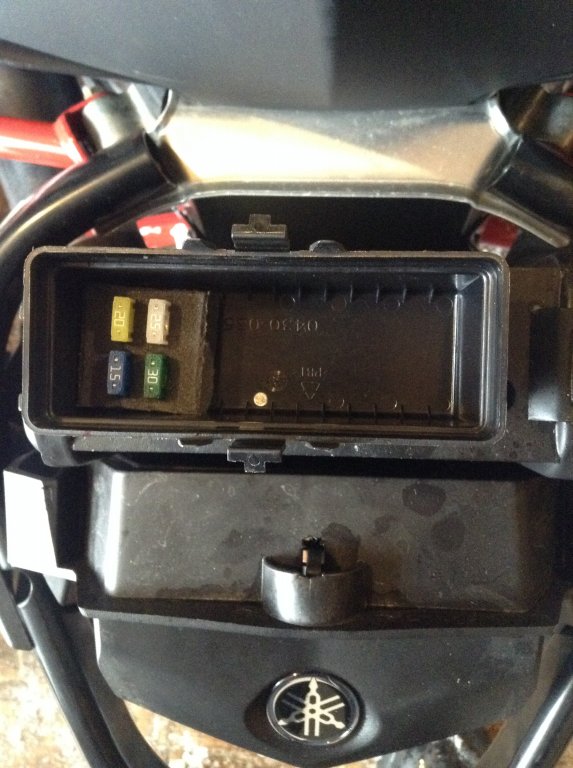

OK so I lied, there are 2 types of relays, the 4 small ones are all identical and the 2 large ones are identical. Notice once the relays are removed you can see what they control. Also tucked up under the fuse box cover Yamaha has included spare fuses.

Very nice...someone should simply sticky THAT IMAGE showing the SMALL CORNER RELAY being the fuel pump.OK so I lied, there are 2 types of relays, the 4 small ones are all identical and the 2 large ones are identical. Notice once the relays are removed you can see what they control. Also tucked up under the fuse box cover Yamaha has included spare fuses. View attachment 134603 View attachment 134604 View attachment 134605
