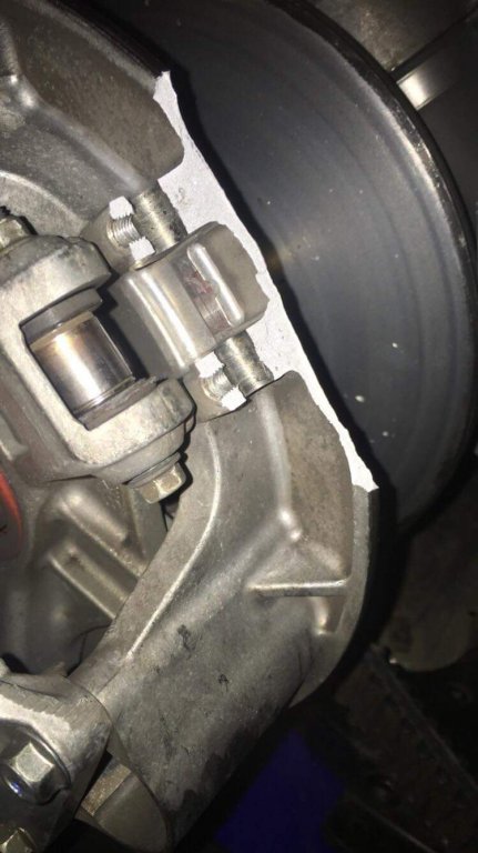

The clutches don't just break all of a sudden, it can usually be caught if you inspect the clutches regularly!
See how the washer on the lower side of the roller is wore, that didn't just happen, the weight or roller had allowed for a incorrect swing for sometime previously.

damn it!The clutches don't just break all of a sudden, it can usually be caught if you inspect the clutches regularly!
See how the washer on the lower side of the roller is wore, that didn't just happen, the weight or roller had allowed for a incorrect swing for sometime previously.View attachment 144487
To me in this picture it looks like the spider is not lined up properly. Could be why the roller bushing is worn.
