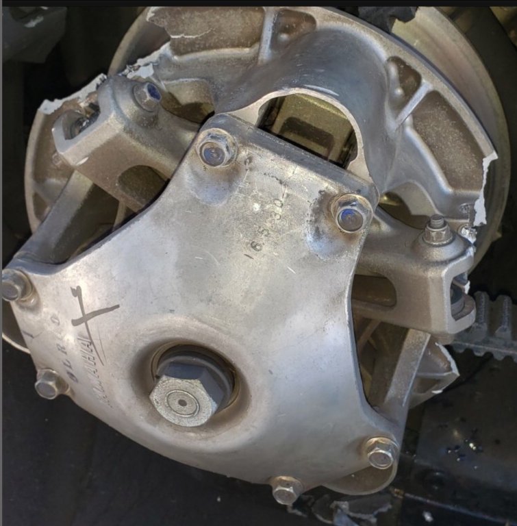

Last longer because it’s stronger, bigger, tougher it might break when it wears out, you have to check when you run big HPHow long before the towers break if the cover cracks like that ? Lol & that clutch looks new compared to the Yamaha clutches pictured .

But it doesn't if the cover is cracked on what looks to be new clutch compared to a clutch with 7300 miles on it minus rollers which is why the clutch broke in the first placeLast longer because it’s stronger, bigger, tougher it might break when it wears out, you have to check when you run big HP

Which clutch looks New
So now put the original poster with the cat clutch, what's the end result?

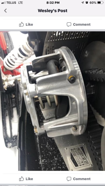

I think we hear a lot less about Cat clutches and belt breaking because they are used to that. If you look at the picture with the Tream clutch higher, why wasting money on a belly pan protector if they are not blowing belts and they are so good. Like I said earlier, I broke 2x 200$ Cat belts at 1400km each at part throttle only about 90km/h.

All you have to do is look at a team and Yamaha side by side. The Yamaha clutch is lacking. Yamaha seems to work good but their flying apart like crazy. The material where the arms attach to is just not strong enough .

True you can’t run them with high HP for 7300 miles and expect them not to wear out, have to serviceBut it doesn't if the cover is cracked on what looks to be new clutch compared to a clutch with 7300 miles on it minus rollers which is why the clutch broke in the first place

Rollers on the Yamaha is not always the cause .

Looks like rollers may be the biggest culprit so far. That about right?
- 5,722
- 4,313
How many stock clutches on stock Winders have had this type of failure? Have there been any?

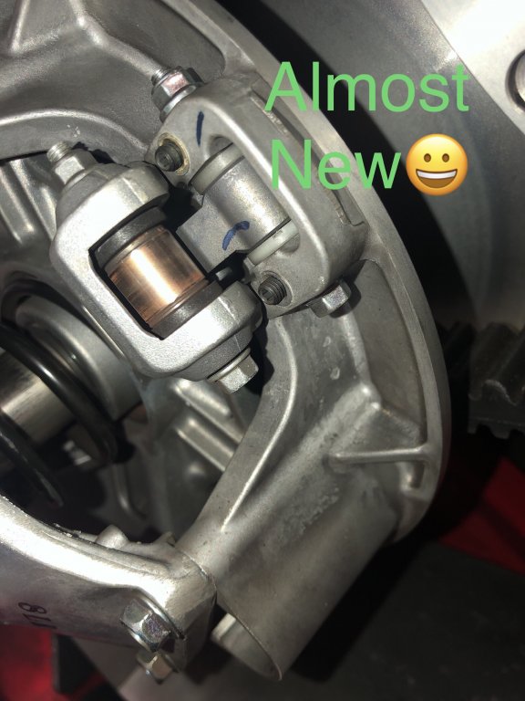

View attachment 144548 Solution........anyone?

Hearing the harmonics on this 3 cylinder is hard on the STM clutch as well.View attachment 144548 Solution........anyone?
