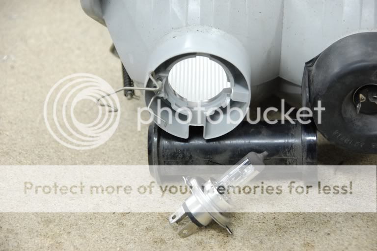

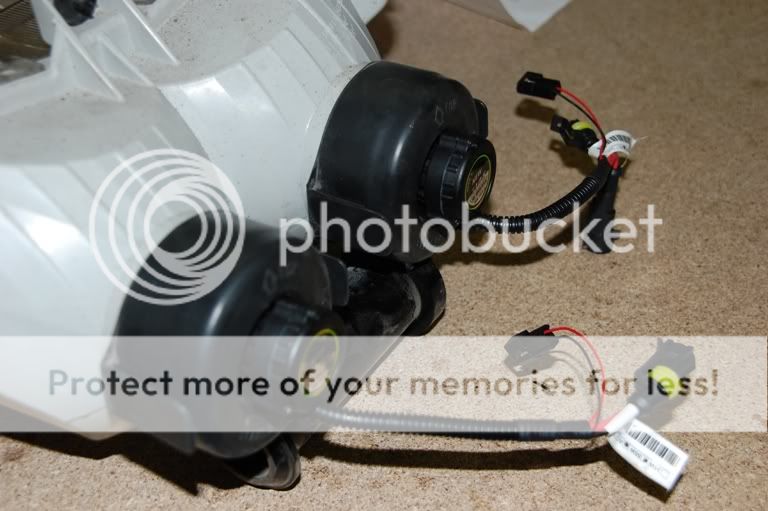

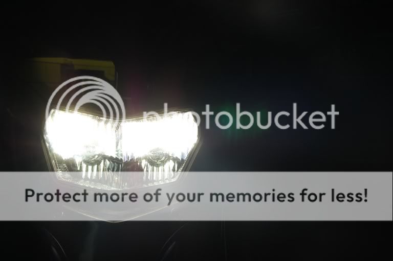

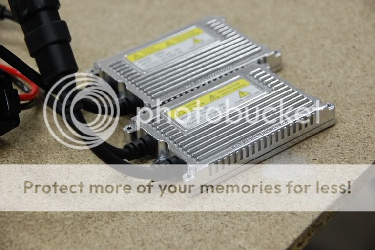

Pics from mounting the HID kit
4300K, 55W Bi Xenon with slim ballast from Humanhabits.
Complete kit with relaycables, ballasts and lamps
Very slim ballasts...good when there is not much extra space on the Phazer
Taking away the original H4
I did split the xenon lamp
The bracket for the Xenon mounted in the lamphouse
Lamps inplace
Above the batteri I did found some space to mount the ballasts
Connecting the relaycables into the H4 sockets
The just to connect to the batteri and tie up the cables
One H4 55W and one Xenon 4300K 55W
Both Xenon in place

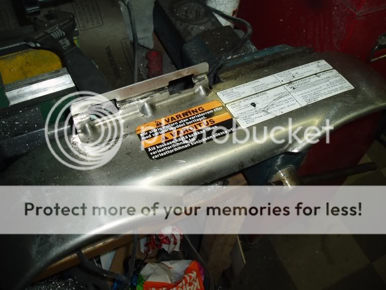

Some pics from tonight
Sec. clutch to be mounted...the cover needs some cleaning
The clutchs and cover inplace
Så nu börjar vänster sidan vaNow the left side starts to be finnished

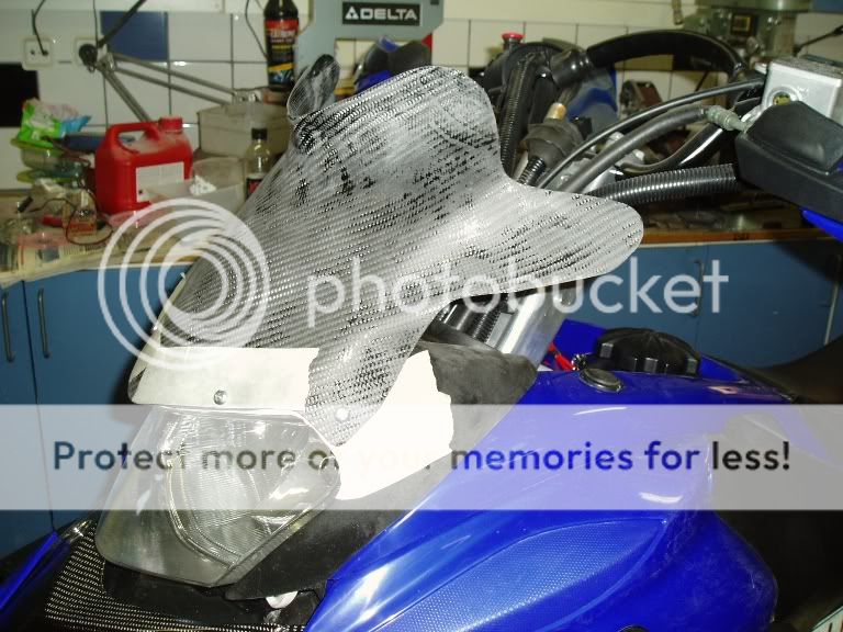

Some more pics
Revalved RTX shocks to the skid
Some more alu.parts from my friend
This will become a "homemade2 offsetaxle
Making the windshield to fit
New place for the speedometer
New bracket for the speedometer
One more layer of epoxy on the windshield
Windshield clearcoated
Skiloops inplace
Speedometer on it´s new place
Rightside cover inplace
Skiloops inplace
