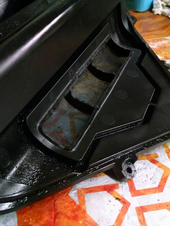

I have a 2016 Viper XT se, I have been reading about do it yourself air box mod by Stingray, I dove into it late this afternoon and Opps ! I cut wrong area ! I took snorkel off and cut nose off under snorkel !Had a major senior moment not going to look at pictures again before I started. Should I cut out area in front off nose ( area that has been shown in pictures ) area that has been suggested and give it a whirl ? ? ? Or am I asking for trouble does nose under snorkel direct air in a way that without it it will cause major issues ? Or do I need new bottom of air box ?

You can also find stock airboxes on eBay, or even here in the classified section for around $50. Even if you need another airbox and the. Do the mod correctly $50 is less than an intake from any of the aftermarket suppliers. A picture of what you cut would definantly help.

They came through. I would keep cutting. The part triangle part. Then try it. You still have the snorkel? It could be welded back on. Its a big enough piece that if it falls off it wont get sucked in. But honestly I would just try it without.
Still need to cut out this area. This is where most guys mess up the screen so either get a replacement screen,be careful or just remove and glue it back on. Windshield adhesive or Permatex Ultra black works great for gluing screen back on. The welding can be done with a heated up old screwdriver.
How does your divider look? The flat piece that lays in the upper part of box. Cracked?
