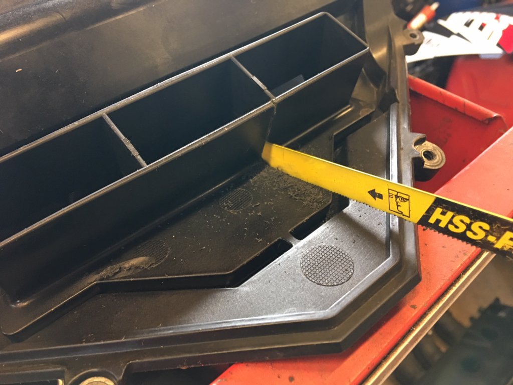

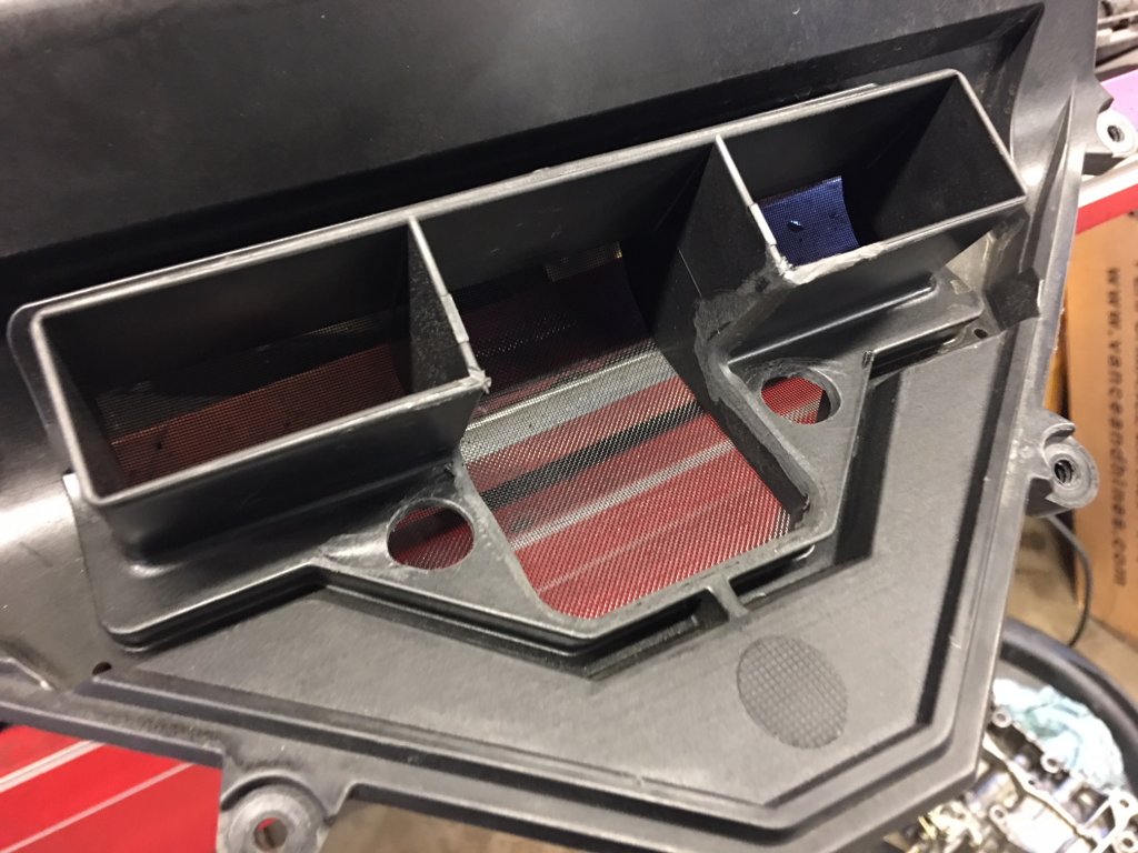

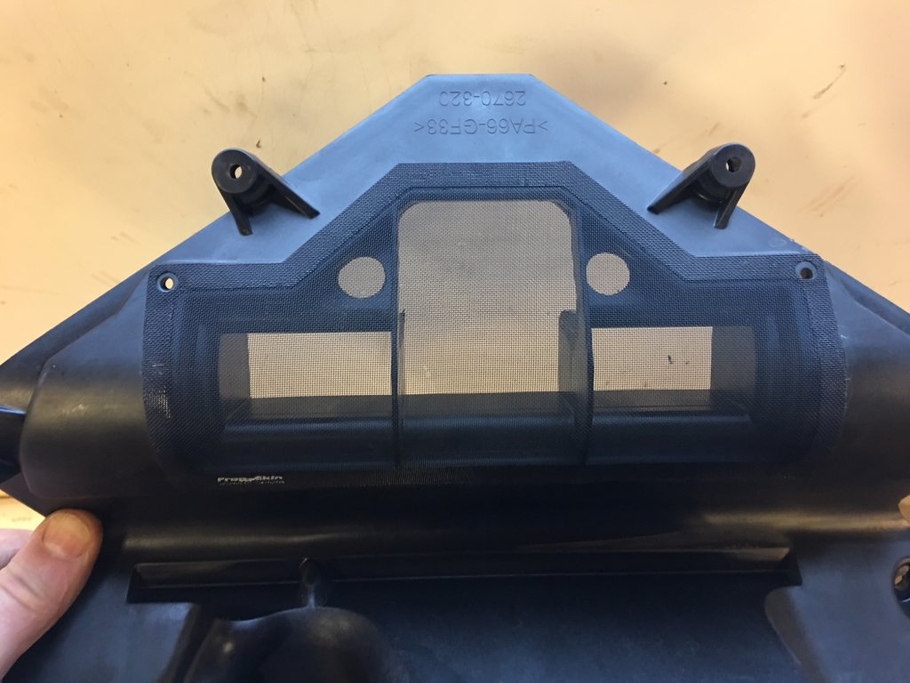

I've read about people modifying their Viper air box and claiming to get better throttle response. I'm all for better throttle response but have been somewhat reluctant to do the modification. I know there are a few versions people have done but the most common mod is removing the snorkel and opening up the air intake. From an engineering standpoint I don't believe this modification was a calculated design but rather cut and hope for an improvement kind of thinking.
I've been sitting around for the past few weeks due to health issues and today I got board so I decided to pull the air box and do the mod. Once in there I didn't like how the original modification cut out part of the web that supported the frog skin so I changed it up a little. I'm not sure what difference this will make but I'll give it a try.

With the modification, or stock the intake temps were crazy warm for me. Around the 80 degree mark. I was sick of it and bought a used ulmer air box kit. Wow what a difference, the highest i have seen was 60 ish degrees. Much better and my engine is happier.

Yes it was. Delete the bottom suction part , I'm guessing because it was sucking air right behind the radiator.

I’ve thought about installing a thin aluminum sheet to keep most of the radiator air from flowing down to the Airbox as easy as it does. I’m planning on adding a few vents by the knee panels too, it should be a low pressure area and help air move through the engine compartment keeping some of he warmer air away from the airbox. I also left the ribs to support the frogskin when I modified mine, though Indidnt cut the extra piece out of the middle stack (though I might now!)
