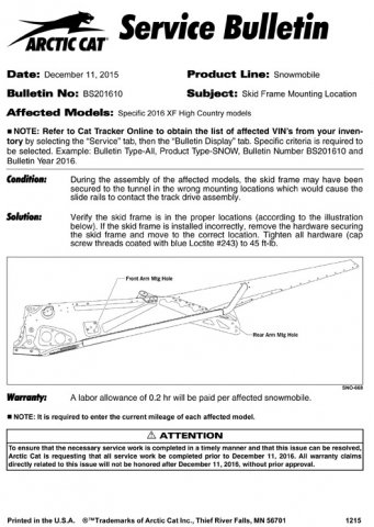

Not sure why you are so reticent to just lower it and fix the problem. Where on here have you ever read that a dealer knows more than the people on this forum? If you read this whole thread there is a link to HCS that has a better readable service bulletin fron Arctic Cat for the High Country.

I told the dealer about the Cat service bulletin, but he said that applied to the Cat mountain sled, and he agreed that the Viper MTX should be mounted in the lower holes. Since the Yamaha specs do not call for the XTX skid to be mounted in the lower holes, it would be optional work done at my election, and he would charge me an hour's labor to move it.View attachment 123990
