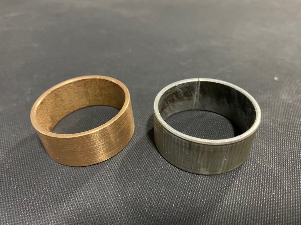

radianguy
- Jan 1, 2007
- 1,953
- 104
- 1,058
Where would one find an oilite bushing for the driven clutch?Exact same thing happened to me last winter. Pictures look the same. First time that I have ever been left stranded on a Yamaha....can't even blame it on Cat DNA....Yamaha clutches. I installed a new replacement bushing with Loctite and it started to move so I am going to try an Oilite bushing instead.
View attachment 159041 View attachment 159042 View attachment 159043
Turboflash
- Mar 18, 2019
- 2,878
- 2,889
- 1,113
- Southern MN
McMaster-Carr?
