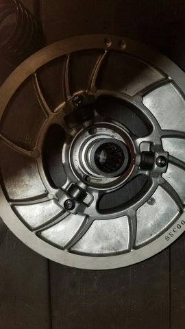

That was how cat did it on there stock secondary on my 2013 lxr turbo,and it worked ok,was much easier than removing the complete secondary,and you could do it trailside with wrench that came with sled.Here is what I have for the secondary.
Note the 3 screws on the back side of the secondary are not longer used. Washers behind the secondary on the jackshaft are for setting proper off set.
View attachment 117770 View attachment 117771 View attachment 117772
View attachment 117773 View attachment 117774 View attachment 117775
They now add washers to the front side in different thicknesses to set the belt deflection.
Reason I did it was anticipation of running 10000 rpm with Evo flash. Wanted all the strength possible. Never went that route though. Have been trying for more power lower in rpm. Much easier clutching and more efficient that way. I do set the side clearance now. Is nice not having to find wide belts.Hi Nos,why would we want a 911 cover,dont the yammie cover hold just as good tolerances as the 911? the 911 would it need taller springs like doo springs,to work correctly,i am sure it has a beefier cover bushing,but I have had zero failures with any Yamaha covers or bushings,unlike cats junk clutches,you had to have a 911 cover and other parts to run a cat turbo,stock,and once boosted,you may as well rebuild the entire clutching,chaincase,and driveline,jackshafts,wobble bearings,man the list was endless.
