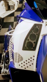

I bought and installed a front set made especially for the Yamaha Sidewinder from Mo-Flow. Called Belly pan vents on their site!
Once marked on the belly pan, Instead of cutting out the entire spot, I just drilled some holes through the belly pan plastic and the clutch guard with a drill bit and finished off each hole with a Unibit for smooth side edges!
I just did the front of the belly pan whereas there is quite of bit of open flow to the back of the belly pan!
Should have done that way back in 2017 whereas these things do not have enough flow on either side!

I made two holes in the front behind the shocks and put frogzskin and on the back I used the Moflow vents

I also have a few forward facing flow rites to help move more air through the engine bay. there is a huge amount of hot air pouring out of these vents even at 20 MPH.
