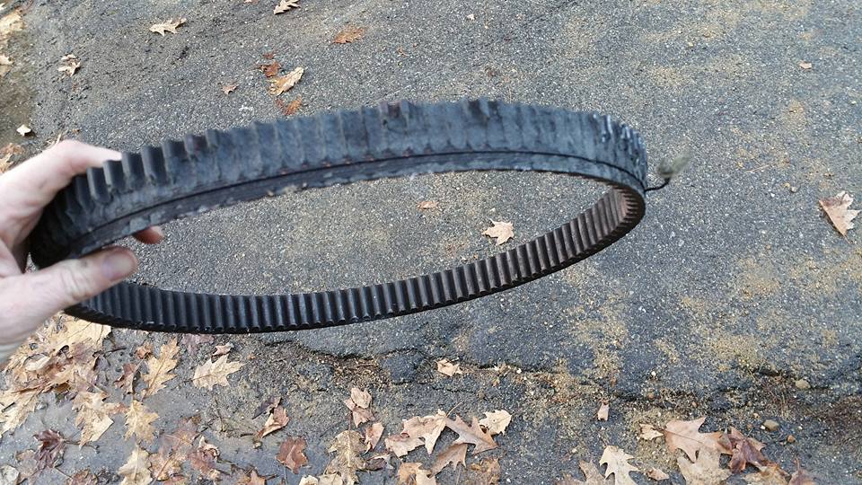

The belts that I have brought in are like nothing I have ever seen - or the service department at the dealer they said. It is sheared down only on one side - the inner side.

flat spot on the roller wouldnt cause that IMHO Im thinking you have an offset issue.
another thing for everyone to check is your frame spars....a loose spar might cause the chassis to flex
Almost looks to me like belt is rubbing on something.Hi,
yes..or that ..but what..oh i know...check under the clutch guard....the rivets hanging down....if your secondary momentarily binds you could get a bunch of slack and the belt hits the clutch guard...there would be black skid "witness" marks to prove this theory...

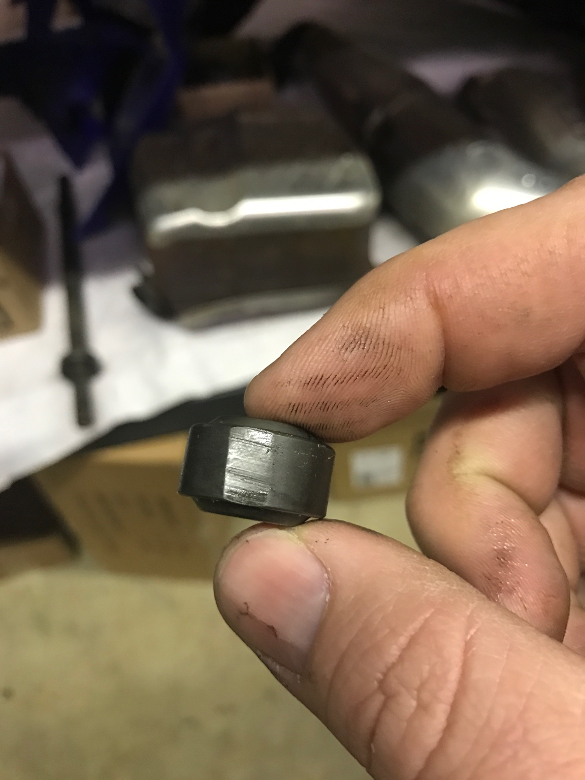

My dealer took care of the loose turbo bolt issue before I took delivery of the sled. I asked him about the secondary roller flat spot issue and he said that I already have the "updated" rollers from the factory based on the build date. I will be putting in my TD rollers that came with the clutch kit anyway so that is a moot point.
