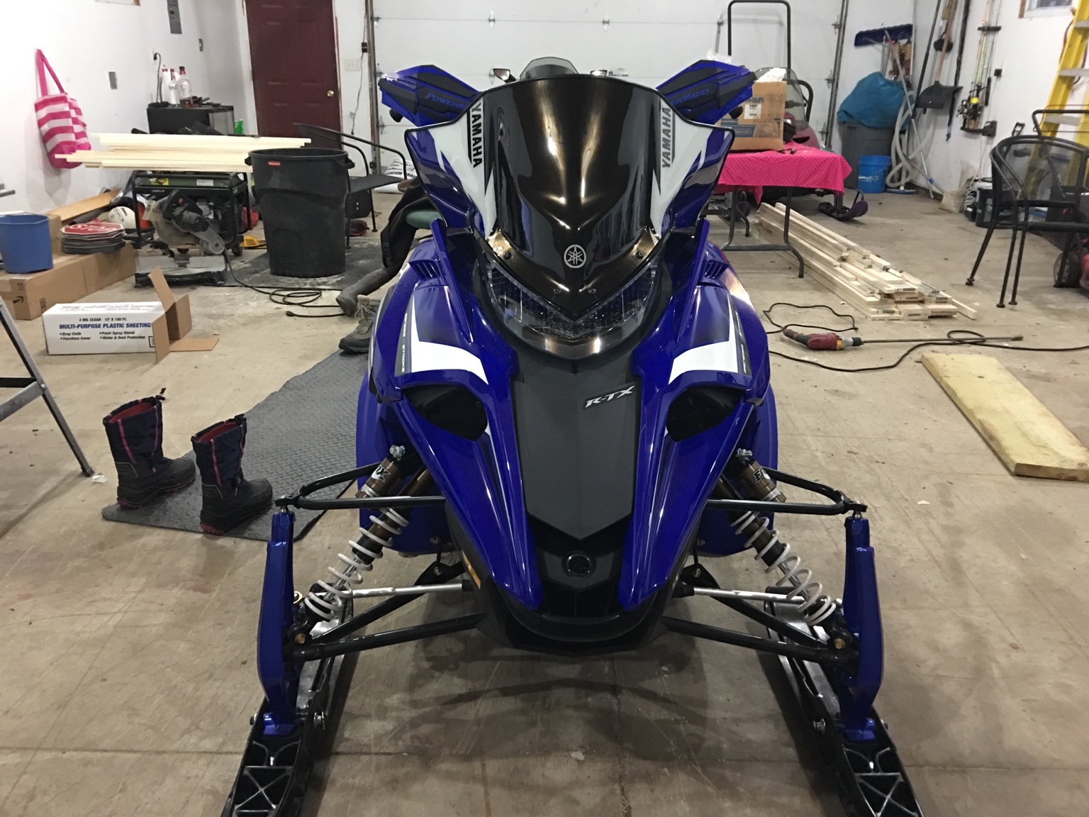

Installed a Viper Sport windshield I got from ebay - SMA-8JR96-20-00
http://www.ebay.com/itm/Yamaha-OEM-...eld-2014-2015-Snow-Sled-Trail-SMA-8JR96-20-00
It actually doesn't look much like the photo in that listing. It does however fit. The Viper tabs actually are not touching anything and add a little window deflection. I am thinking of making a little tab secure the windshield tabs to the headlight/hood.
Im not sure how this compares in size to others but its not humongous. It measures 21" from point to top. I have the adjustable PowerMadd riser and my Sentinel hand guards do just barely clearly the windshield sides.

What's that?
Sent from my iPad using Tapatalk Pro
actionjack
- Apr 9, 2005
- 2,519
- 623
- Westminster, Maryland
- www.inspectorjack.com
- 2017 SideWinder LTX-LE
Torx screwdriver that comes with AMPS GPS mount for security screw.
