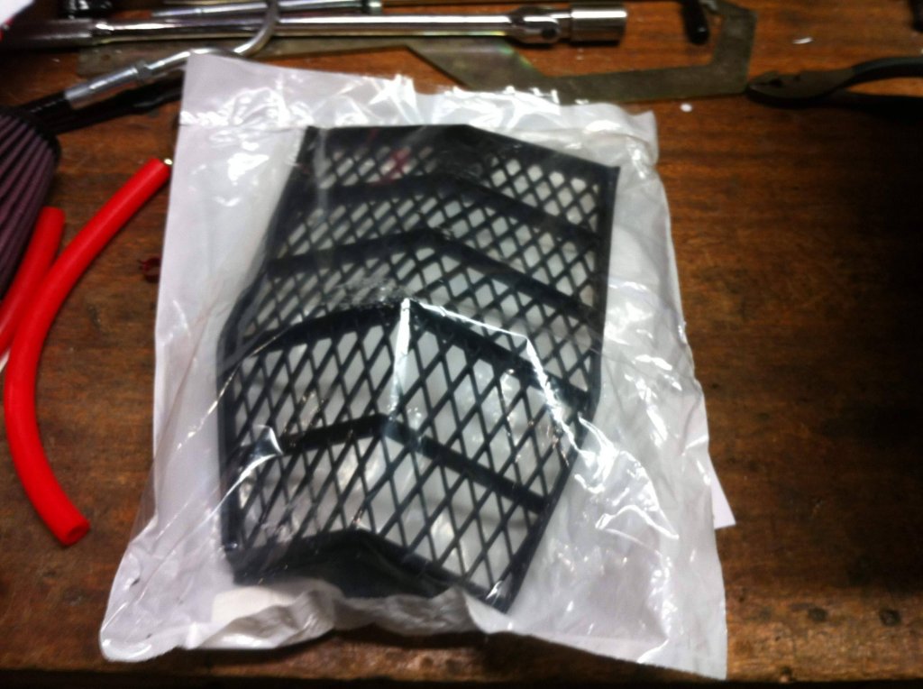

Try some vent screens, also, lots of guys are changing to Cat front grille in front of intercooler as it sheds snow better. One guy even put frogskin wrap around it and really seems to work as intercooler stays clear.

I got a cat grill too....very cheap bolt on part, but it looks ugly as sin IMO(cat like) and loses the nice shelf with 50th logo.
Figured id have it hear for certain days if need be.

I don't like the look of the Cat one either Dan or any of the other aftermarket ones. How much better is it than the Yamaha grill? I think they will all plug up in deep snow and for normal trail riding they will all keep clear.I got a cat grill too....very cheap bolt on part, but it looks ugly as sin IMO(cat like) and loses the nice shelf with 50th logo.

Following closely in a group on trail mine stock turned into a block of ice.I don't like the look of the Cat one either Dan or any of the other aftermarket ones. How much better is it than the Yamaha grill? I think they will all plug up in deep snow and for normal trail riding they will all keep clear.

Barn of parts sells a nice grate for the front of the grill/intercooler that is frog skinned and works great. I removed my nose cone on mine and installed it, some guys modify the nose cone to fit around the grate/screen leaving it intact.I have a 17 sidewinder and with very little powder riding the front end of the sled is just blocked with snow. It doesn’t seem to run too hot but when I shut it off it gets very hot. Anything I can do to keep those vents clean ?

Dan how much was the cat grill does it work better than yamahasI got a cat grill too....very cheap bolt on part, but it looks ugly as sin IMO(cat like) and loses the nice shelf with 50th logo.

Cat grille works great I got one!

How much did it cost?Cat grille works great I got one!
