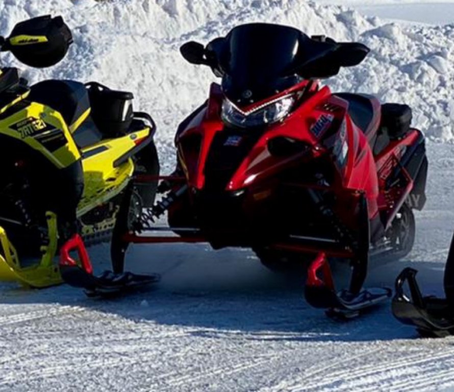

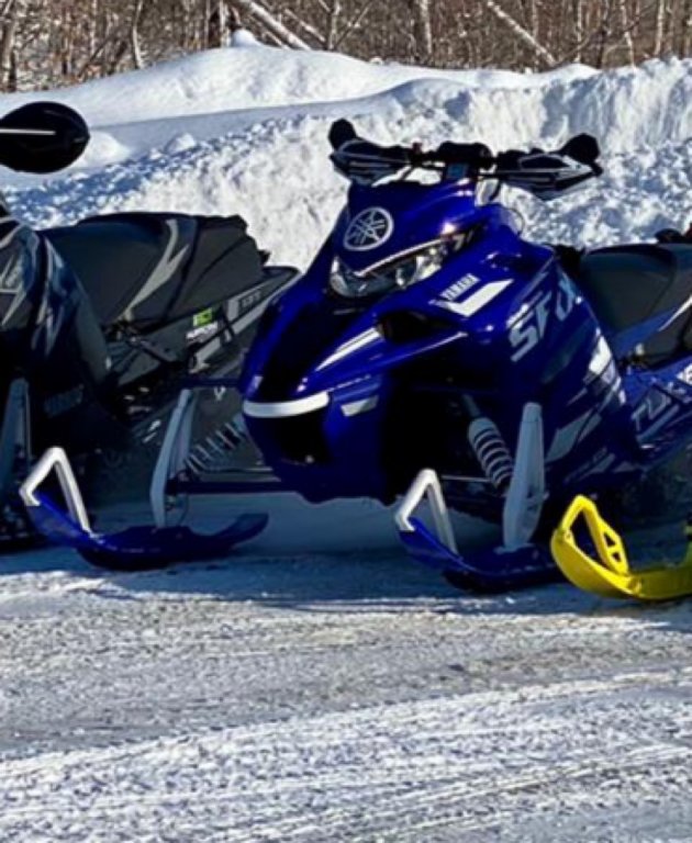

So, did you shim yours to lay flat? Or change ski?Jonlafon I totally agree with what you said, I also get the twitch from time to time and the push/under steer. I’ve been running trackers since my 2011 apex and that sled used to rail the corners way better than my sidewinder does, I tried every possible suspension settings and it always feels the same with little affect, I’ve been thinking this a lot lately because I know how good trackers are and came to the conclusion that it’s the cat ski causing the issue and not making the tracker work like it’s supposed to.
Trackers need to lay flat on the ground to work properly, not the best pics but as you can see in the pic of my sled “red sled” the skis are angled up and on the other pic “srx” the skis sit level. That’s the issue why they don’t work like they should. View attachment 160336View attachment 160337

Bingo. Good pics and post!Jonlafon I totally agree with what you said, I also get the twitch from time to time and the push/under steer. I’ve been running trackers since my 2011 apex and that sled used to rail the corners way better than my sidewinder does, I tried every possible suspension settings and it always feels the same with little affect, I’ve been thinking this a lot lately because I know how good trackers are and came to the conclusion that it’s the cat ski causing the issue and not making the tracker work like it’s supposed to.

That twitch is because the front U blade on the tracker is not in contact with the trail especially when on the throttle. In the pic I posted you can see the tuner with trackers sit perfectly on the ground, that how it should be.I will say this. The aggressive do and can work on a cat ski BUT you need to really tweak your settings. And you better have transfer and understand how to make a sled do it. I just couldn’t get past those twitchy slight wiggles that really kinda surprise you. If I ran them super hard like a total maniac on the trail they were better and really stick like glue in the corners Just to much work for me. They are doable if you run them SUPER hard and do t mind a twitch that fills your shorts once in a awhile?

I agree about the U blade. That’s why I mention transfer. If you have very good transfer they are great in corners because as you said the U blade is doing it’s job.That twitch is because the front U blade on the tracker is not in contact with the trail especially when on the throttle. In the pic I posted you can see the tuner with trackers sit perfectly on the ground, that how it should be.
Do the cat skis normally angle up with just regular carbides ?
I have been running cat skis for many years and miles. The semi work great IMO for slightly less aggressive riders. They work great if you have transfer for aggressive riding also. Now in years past I feel the cat skis needed shimming. Lately as of 17 or so I feel something changed in the chassis and shimming is not needed nearly as much as say 16 and older Cat pro cross chassis. So yes the skis do have a very slight upward angle to them. I have. 21 cat here and girlfriend loves the semi. They don’t sit like aggressive though. The ski is slightly flatter.

I’m wondering if a modification to the ski rubbers would be something to try. Have to make those aggressive sit FLATTER on Cat skis to the ground. So less rubber on the forward area. Or just run Doo skis as Mike says?

All this info answers why I have been chasing suspension setting with little affect LOL. I to was thinking of trimming the rubber in front of the spindle. I don’t find them horrible like this but there’s definitely a lot of room for improvement. I’m leaving Wednesday for northern Ontario if I got time b4 I leave I will take a look and see if trimming the rubber is possible.I’m wondering if a modification to the ski rubbers would be something to try. Have to make those aggressive sit FLATTER on Cat skis to the ground. So less rubber on the forward area. Or just run Doo skis as Mike says?
