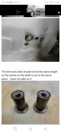

Those bolts have been known to rip through the tunnel. Those plates reinforce the area to prevent this.what’s up with those black plates on the rear suspension front mounts ?

Those plates won’t stop it, get a better centre spring and heavy duty cross shaft like hurricane sells.Those bolts have been known to rip through the tunnel. Those plates reinforce the area to prevent

Holy #*$&@ thats gross. I put the BOP's HD cross shaft in as well.The shaft is the problem

I have had the tunnel crack in that area without bending the cross shaft.

I've seen many sleds with hairline cracks radiating outwards from the mounting hole. These BOP plates reinforce the mounting area and prevent that.what’s up with those black plates on the rear suspension front mounts ?

BOP sells a nice stainless steel cross shaft to replace thhe stock aluminum one.

The stock cross shaft flexes cuz it's too thin that's what causes a tunnel cracks.

Yes but those plates will not stop the damage from a broken cross shaft. Seen it . The issue is a weak front spring allowing the really short front shock to bottom destroying itself. Now you are hammering that wimpy cross shaft, it’s gonna break . Ive replaced and rebuilt dozens of these shocks and until you put an adequate spring and crossshaft in there you’re on borrowed time. Unless you weigh160 lbs soaking wet. Checking that shock should be done frequently.I've seen many sleds with hairline cracks radiating outwards from the mounting hole. These BOP plates reinforce the mounting area and prevent that.
