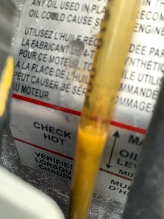

Well no good...stranded in the bar. Its still eating coolant mixing it with the oil. As soon as it drinks it and gets low enough it goes in and out of limp mode. The picture was after 60 miles. Now with almost 90 the oil level continues to rise. Same problem since day 1! Two new motors, 3 new head gaskets 1 of those with ARP. 2nd Head was checked by a machine shop for flatness and pressure.
I am at a loss....
I am at a loss....
I am at a loss....
Kinger,
Did you check your head for cracks, a few of them had a small crack at the coolant plug on top of the head between the cams. Like plug was over tighten from factory. There’s a post on arctic-chat.
kinger
Yes the first had had that crack, this is a new head and was good.
