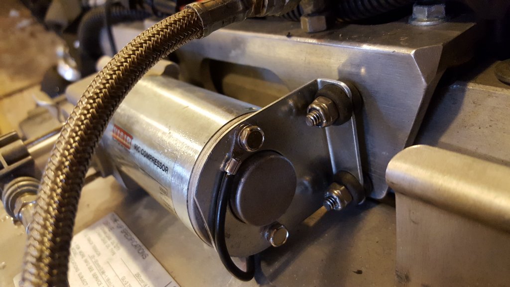

I have not had an air line failure yet.Thanks for the pics of the extensions its straight forward.... how durable has it been for ya? any issues with them . Also would think I could find the hoses from a supplier ?

Wire harness is complete and the system is fully operational.
Here's a few pics of the construction:

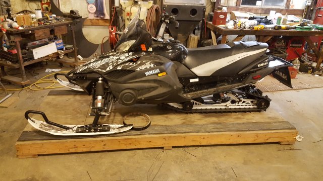

First report:
300 miles so far with no issues. This skid, combined with the new 1.5 lug track, just rocks...period! Air pump and solenoids are all working correctly. It's nice to make front or rear air pressure adjustments in seconds while moving.

We just returned home from an entire week of snowmobiling in the UP and the sleds are now drying off. I only had one glitch with the Vector on the trail; the air compressor quit working on the last day about 100 miles from the hotel!
I thought maybe it froze up, but it turned out to be a loose ground connection. Easy fix and back in service!
I'm very satisfied with this sled and it's perfect for long trips; lighter than Apex and better fuel economy.
