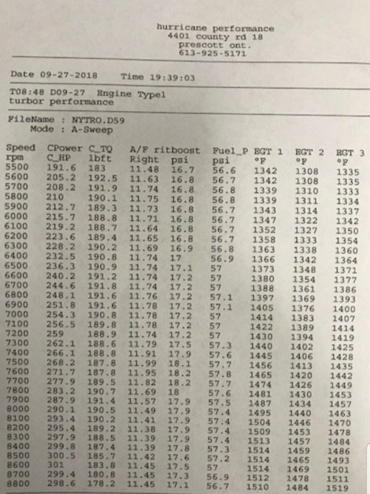

Hey maybe they make an srx wrap, lolView attachment 154800
Yes I am going with with design engineering titanium 2 inch wrap
Looking at this dyno sheet it's shows around 1500*f
