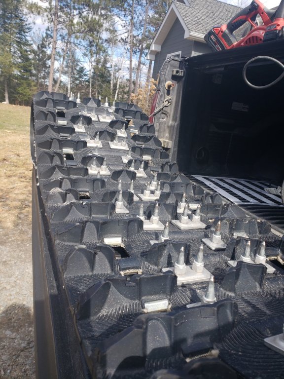

Decided to run the stock track one more season before swapping to1.50

What size studs are those ?View attachment 154911 Getting track ready to go back in adding studs to the outside edges and sharpening the existing one
Decided to run the stock track one more season before swapping to1.50View attachment 154910
I had to change my track , due to OWNER NEGLIGENCE , and replaced with the same 1.25 stock track but with 1.325 studs rather than the 1.5 that I previously had (bought a used set up as was considering selling ) and my SOTP feeling was a big difference in all aspects of gription .
I would have gone to the 1.5 with 1.75 + studs , and in fact may still , if I decide to keep the sled OR put that set up on what ever sled I buy , which would be an SRX or an LTX-LE , which will have a 1 or 1.25 stock track .

They are 1.450 megabites not sure if I am going the put the same on the outside I may go with gold diggersWhat size studs are those ?
I.am definitely going 1.5 track after next season
